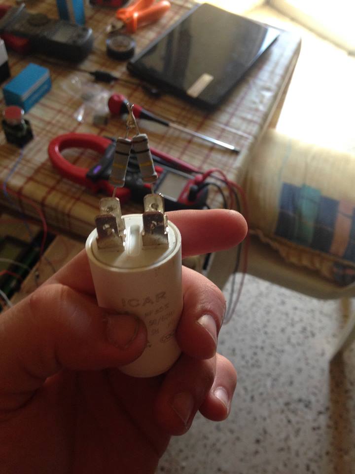

Hello,
Using the 60W fan, I tried to parallely connect at its terminals a 6uF rated at 450VAC, to see what happens:
I connected two 2W 100K bleed resistors in series, like the image:
The results were:
same power factor.
more current drawing from 0.2Amps to 0.4Amps :lol:
Any explanations?
Thank you

connecitng a 6uF capacitor (ideal) to 204V:
gives xc = 1/( 2 * Pi * 50Hz * 6uF) = 530 Ohms.
This gives 384.9 mA recative current
now subtract the capacitvie reactive current from the inductive reactive current : 160.3mA - 384.9mA = 224.6mA (capacitve) reactive current.
the remaining total current is (pythagoras of 224.6mA and 174mA) = 284 mA
--> either your voltage and/or current is not sinusoidal, or there is something wrong withc our mmeasurement/calculations.
How to calculate the compensation capacitor:
The reactive current from the fan is 160.3mA.
The compensation capacitor needs to generate exactely the same current (but in opposite direction).
Therefore Xc should be 204V/160.3mA = 1273 Ohms.
C = 1/ (2 * pi * 50Hz * 1273 Ohms) = 2.50uF
Klaus

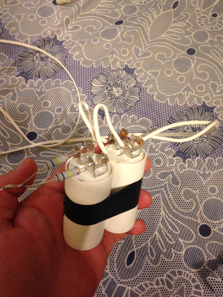

Hello c_mitra,
I did your requested test:
Connected two 6uF in parallel to get a total of 12uF and connected two 100K 2W series resistors across output terminal.
I connected this load to PIC system and saw that:
The current dissipated in such load is 0.857Amps
The phase angle is 0.000
The power factor is 1.000
here it is the connection:
Thank you
12uF give 265 ohms.
204V / 265 ohms gives 770mA.
Phase 90°
Power factor near 0
Klaus
Ok, this is now easy to study. You have 12uF capacitor and 200K resistor in parallel.
Assuming frequency to be 50Hz, we get Rc=1/(2*pi*f*C)=265 Ohms; as this is much smaller than the 200K bleeder resistor you have put, I can ignore the 200K. I hope this is clear.
(same value Klaus reported above); voltage you have not reported but using the current I get the voltage as 265*0.857=227V (very reasonable number).
Both phase angle and the power factor reported are obviously wrong. Phase should be close to 90 and power factor should be close to zero.
This is a software problem. You need to debug the program. I have some idea about the PIC and I can try to help. Can you please repost the part of the program used for calculating the phase?
Just to be complete:
Lets calculate wit the values of c_mitra: 12uF, 50Hz, 200k, 227V
So the current through the (perfect) capacitor is 0.857A
The current through the 200k resistor is: 227V/200k = 0.0011A
Now you can draw the triangle in a carthesian diagram:
One line from zero --> 1.1mA to the right. (This is the real part. This current causes heat. This is the current caising true working power)
From this endpoint --> 857mA straight to the top (capacitive currents are allways straight to the top. Causing no working power)
(Inductive currents go straight to the bottom. Also causing no working power)
Now complete the triangle with a line from zero to the endpoint of the capacitive current (vector). This here is hard to do, because the real current is that low.
But you see the resulting current is almost the same as the capacitive current.
The angle you have to measure with respect to the horizontal line, (starting from zero) --> it is almost 90°
Klaus

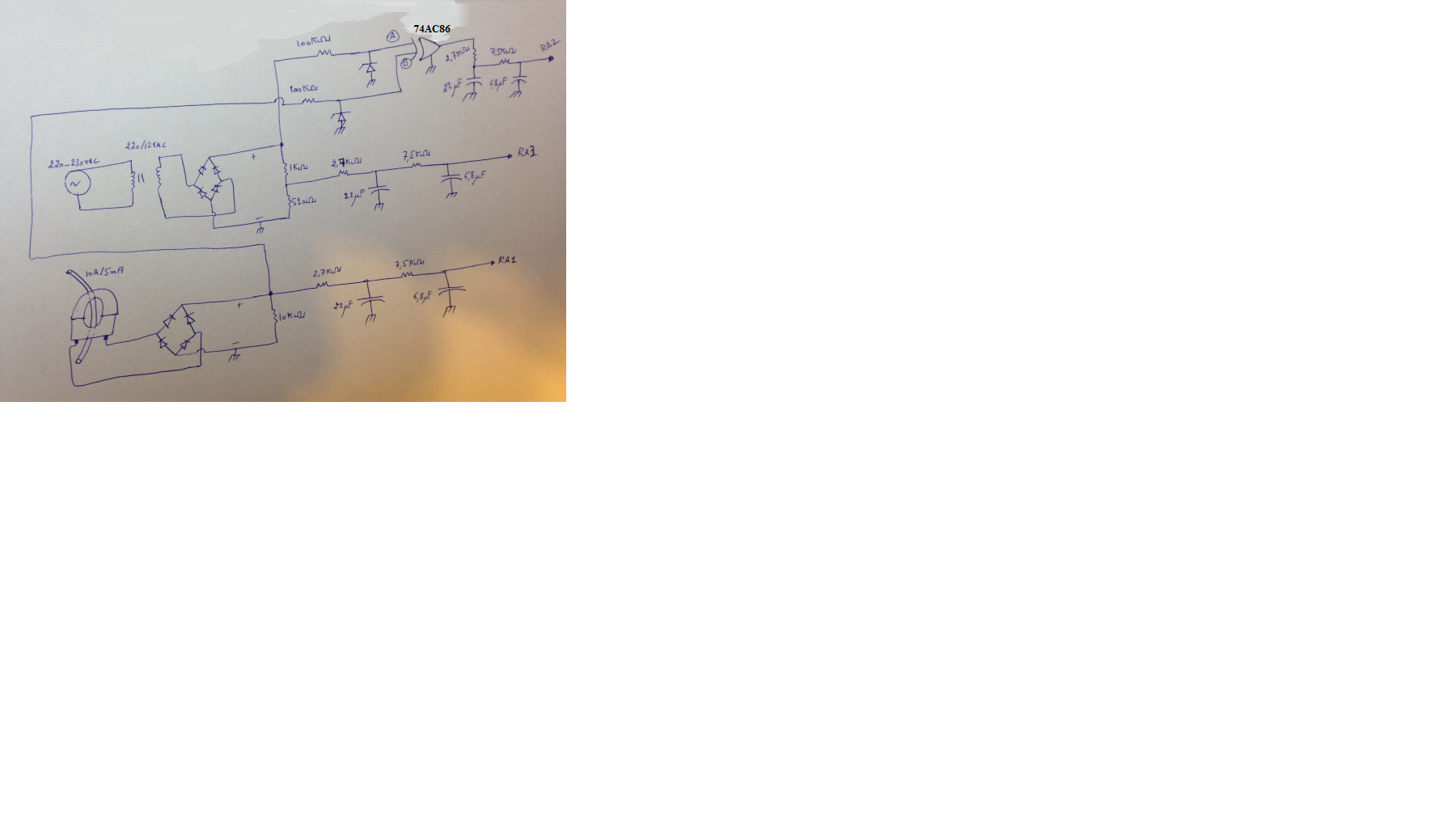

Hello c_mitra,
I thought that I`m done with measurements, but it seems that there is a problem...
Here's the circuit used for pf measurement (I`m using a XOR to seek pf): betwixt method
Here is the BASIC code, used for pf measurement:
**note** V, and I measurements are very O.K and have no problems.

What I`m amazed is the zero value, this means when I connected the cap bank of 12uF with 200K bleed resistors, the XOR gate saw it as purely resistive, and V and I were in phase since no output (low logic) was detected at the output of the XOR gate which is the input for phase measurement.
Using same code/circuit the system sees the fan V,I phase as 43 deg, and 0 for 200W resistive bulb.
I don't know why the system saw cap bank as resistive.
The problem isn't from software, if it had any other value than zero, we can say that there is an error in the code, but '0' means that there was a 0V from the output of two XOR inputs of 74AC86, this is an electrical problem, or there might be another definitions for this.
Thank you
