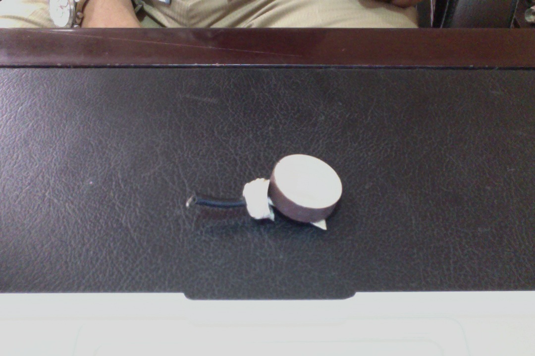

I am enclosing the pic of the Possible ferrite with coating,two of these with a small very thin film in between is Bobina,kindly suggest me what material is this and what kind of coating is this..
This looks like a piezoelectric transducer to me. Can you post a picture of the complete "bobina", with the coils in place around the "core"?

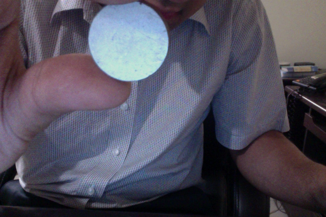

Thiese are the pictures,basically this Bobina coil is this small plate as shown sandwithched between the two of ferrites like these.
The schematic shows the "bobina" as though it were a coil or transformer. I'm not sure I can see the coil. It looks like you have a triangular piece of metal with a short piece of coaxial cable connected to it. But, there is also something white between the cable and the triangular piece. What is the white thing? Can you get a close-up photo?
An important test you can perform is this; see if the material of the disk is magnetic. If it isn't, then it isn't ferrite.
I've attached a couple of pictures of a piezoelectric ultrasonic transducer. You'll notice how much it looks like what you have. The silver coating on the flat surfaces is an electrode. I've soldered a couple of wires to mine.
