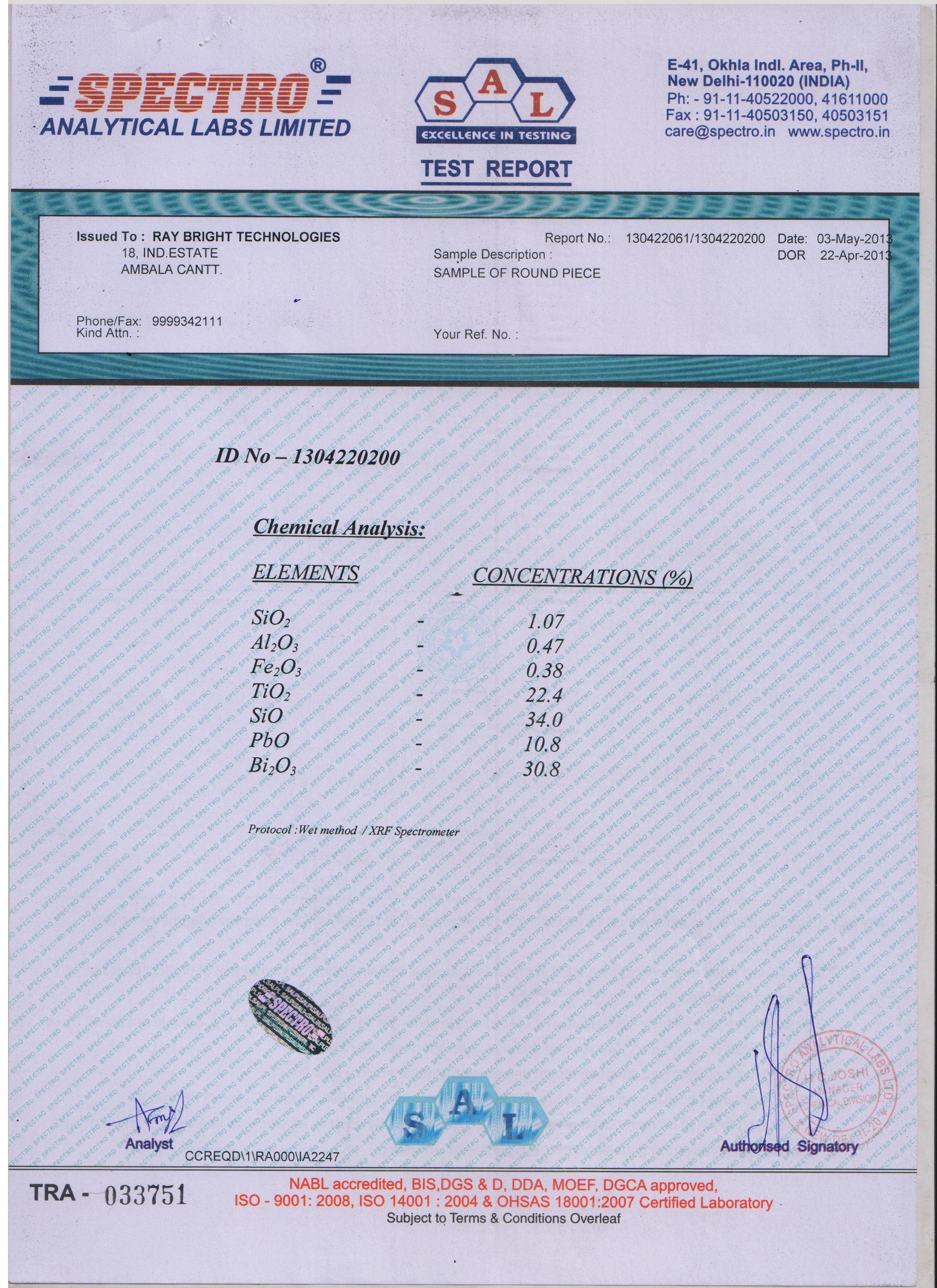

Dear Sir,
I have got te chemical analyses done for the ferrite like thing,please find the report attached,kindly suggest me suitable materials for this inductance.

We have found out that the Bobina is a peizo ceramic with silver plating on both sides.Please suggest from where I can get this peizo ceramic.
Go back and re-read post #22 where I said "I believe the two discs are made of some dielectric material such as barium titanate. One disc then can act as a very high voltage capacitor." I've been trying to tell you that the "bobina" is a capacitor. Go back and re-read my posts, especially where I asked you questions you didn't answer.
Now, you say that it is a "piezo ceramic". If it is just a ceramic material with silvered faces, then it is a capacitor. The word "piezo" changes things. "Piezo" means "pressure". A piezo ceramic is intended to generate a voltage when mechanically stressed. Sometimes they generate a high voltage when mechanically struck, perhaps to ignite the gas in a barbecue grill.
Then can also work in the reverse mode, where when a voltage is applied, they generate a mechanical movement. This is what ultrasonic transducers do. The image I attached to post #19 shows just such an ultrasonic transducer.
In your case there would seem to be no need to generate a voltage pulse when a mechanical impact is applied to the "bobina". At least, you haven't mentioned that an impact is needed to ignite the xenon lamp.
You should connect an LCR meter to the silvered faces of the "bobina" and measure its capacitance. Then you can buy a high voltage capacitor with the correct capacitance and voltage rating.
