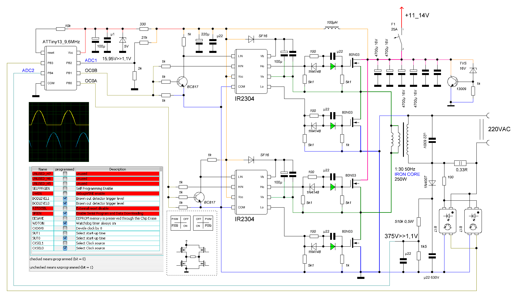

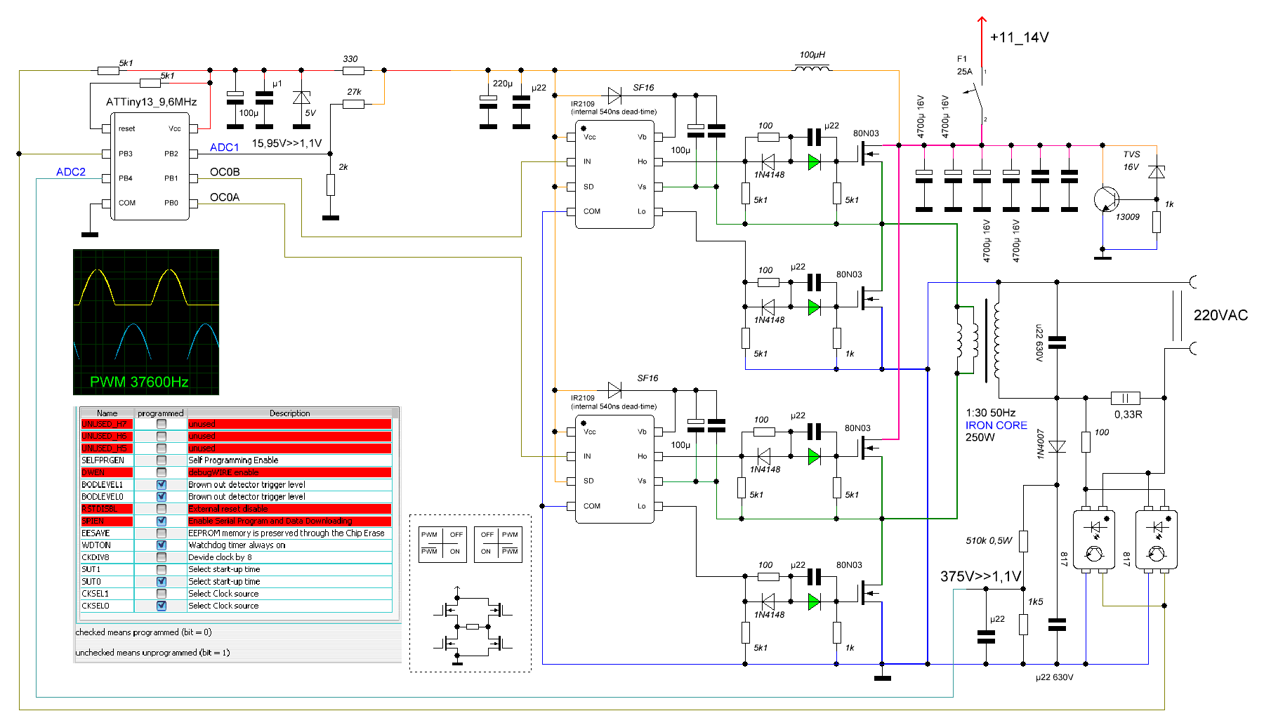

Whats the difference between the two scheme..
also tell me do you have HV version of tin13 based inverter 350v DC to 220v AC
Difference in used driver chips - ir2304 versus ir2109. And i have no 350VDC version, moreover this schemes is not tested in hardware.
________________________________________
scheme of ir211* to ir2304 equivalent. But ir211* is much more moody chip than 2304.
With a little modification in hardware this attiny13 version can be adapted to HV version?
As for IR2110 is concerned it is widely available here a 1$. and the dead time can be implemented in firmware by putting some blank entries in the tables at the start and end depending on the timer interrupt value.
for this needs dead-time delay 1,2 - 1,5uS in drivers, as minimum.
but with plenty of forgeries, additionally beside me it's cost is around 3USD.
As there is only a single table the dead time can be easily be implemented by putting some 0,s in the table at the end and beginning.
for me is better to use cheap STM8S mcu with onboard 3 complementary outputs and dead-time insertion, instead of thinking up about software dead time generation on old Atmel mcu's.

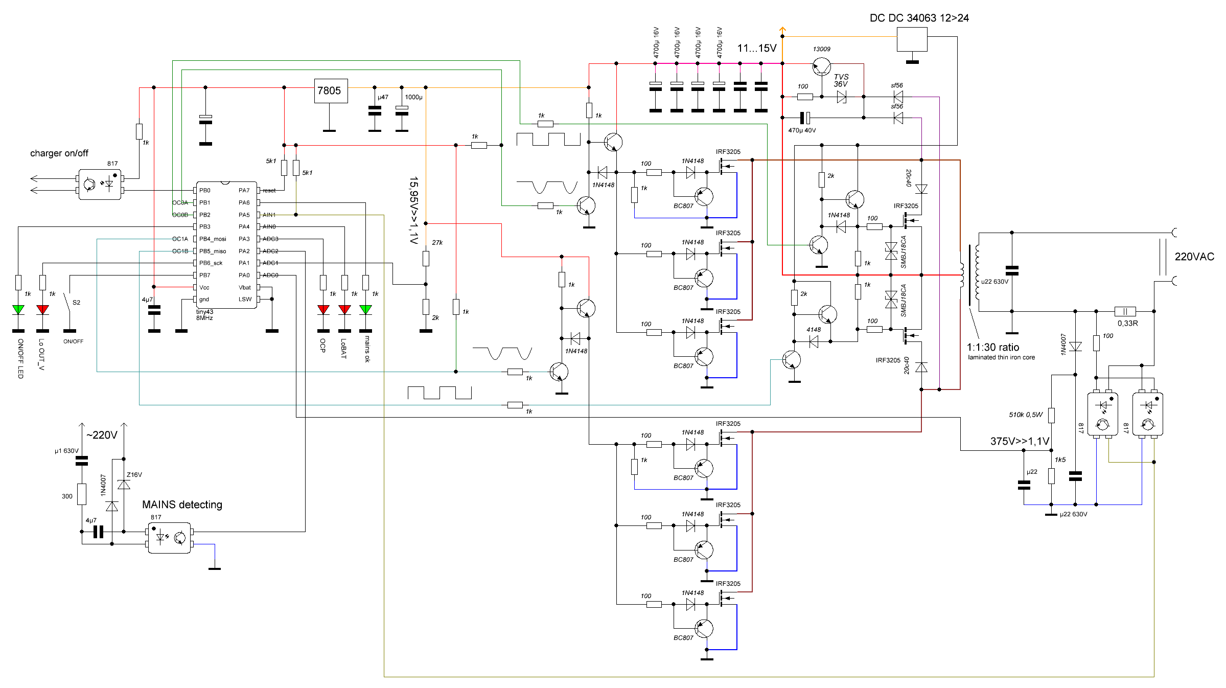

Hi DeepOne!
I could,nt understand this topology If this is Push-pull then why you are using 4 signal from micro-controller.
Hi, Naseerak.
generally it is sligtly modified push-pull topology.
for me is curiously enough as this will work )
______________________________________________________
Would you please explain its working?
