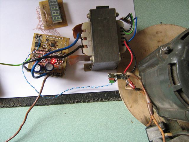

STM8S test version. Only with spwm, nothing more. 25W load test is ok.

did you check wave form on motor load ?
what's about mega8 circuit hv waveform ?
if this mega8 scheme from last schemes waveform must be not bad.

Full version of stm8 firmware, but without deep testing and smoothing corners. However this spwm converter pass 30 min testing with around 100W motor load.

hi DeepOne ,
i appreciate your work. i hav Q would be use same scheme for atmel mega8 instead of stm8s?
Hi Waqasjamil. AtMega8 has no hardware pwm dead-time generation, so some scheme would not be used.
ok and would be Atmega8 transformer version use for +315v?
I did not try so not entrust for this. Can be if contribute some improvements.. but this will much more simply with stm mcu.
Dear DeepOne,
As stm mcu hardly available here ,so i have no option rather than atmel or pic and early i use your scheme mega8 dip version and it's awesome... i successfully run circuit on real hardware . now i try for +315v using ir2110 using same firmware
