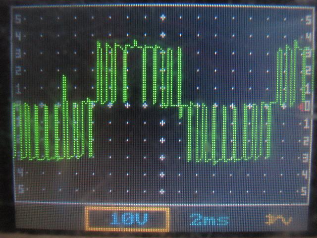

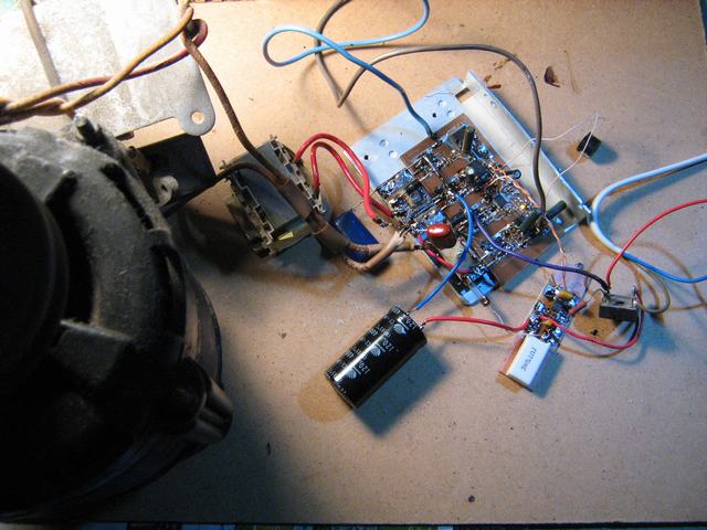

15 min 25W motor load test is ok.
and wave form during load still sine or close to sine?
There whole nine pulses on half-wave, so waveform not very close to sine, but this is acceptable for motor application.
Capacitive load is possible to connect to transformer only through inductor.

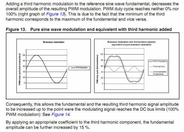

I do not see such projects, but can be something in someplace with automatic waveform corrections.
However for feeding AC induction motor quite often specially contribute some distortions, for example - like described in
UM0712 ("STM8S three phase control software library")

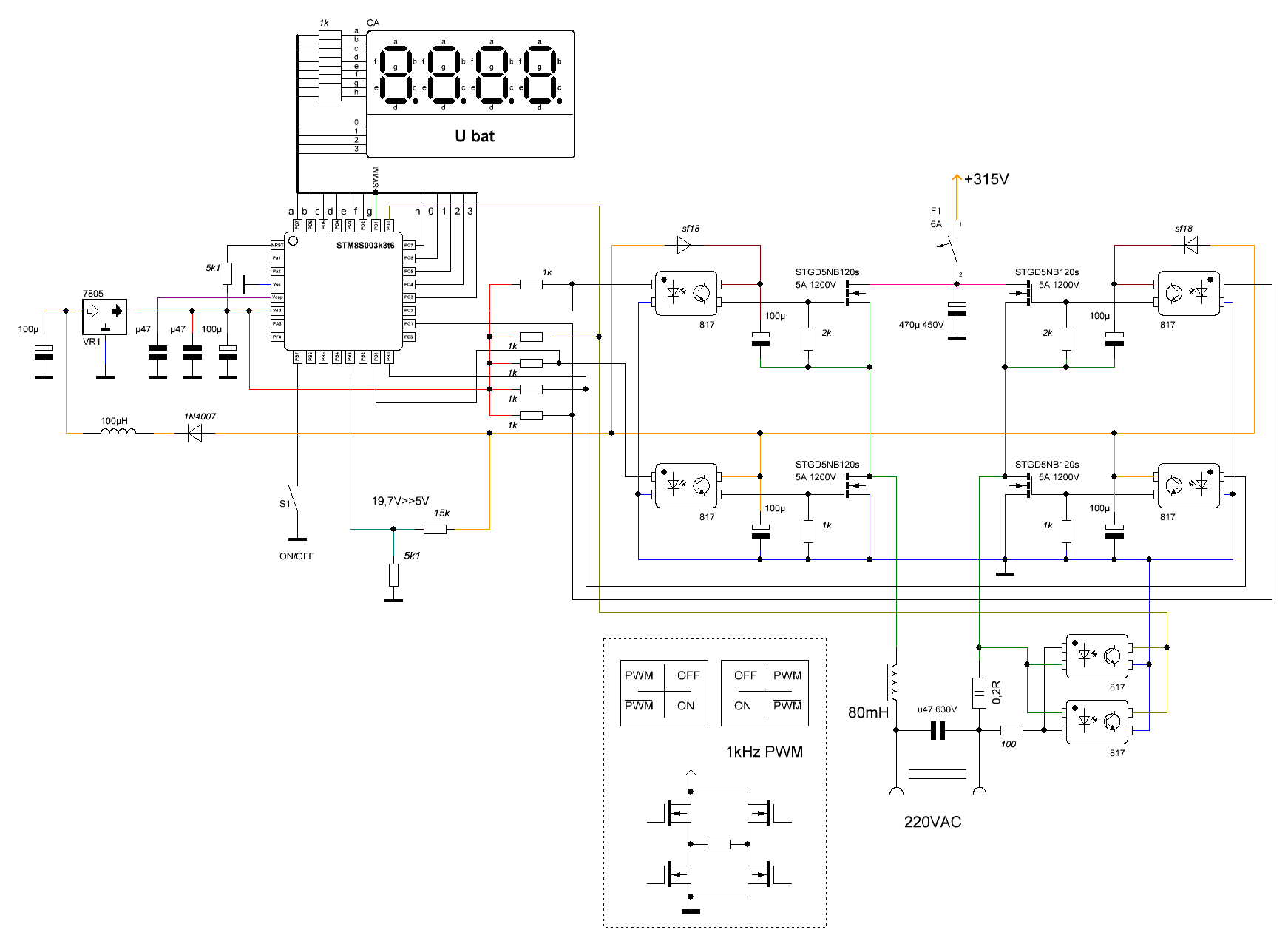

Can you explain in some detail the functioning of your output current sensing circuit? What is the function of the two interconnected optocouplers (PC817) and what does the 5.1k ohm resistor at the micro's side do?
Also what would the expected output power be when using a single IRF3205 in each side of the H-bridge?
Thanks.
Hi, Sghr220.
When output current exceed some value, voltage on current sense resistor go to sufficient value for opening optocoupler and mcu pin to be shorten to common wire. As result mcu switch off power fets (or that is there provided in microprogram).
Optional resistor on mcu side used for increasing hindrance stability, because internal mcu pull-up has too big resistance.
i think not more than 500W with 12V feeding

@Deepone what is the carrier frequency and can we adjust the the value of the trigger voltage to adjust the trigger voltage for ADc of the micro. my other question is the use of this circuit for 24v operation.
If you bear in mind the last circuit - the carrier frequency is 1kHz with 25 points of pwm resolution. I think it is possible to enlarge frequency up to 5kHz.
It may be changed in source code or with ADC resistors divider.
In this case It is necessary to take care of voltage limiting for fets G-S. And adjust voltage for mcu battery voltage detector. Also will be necessary worried about mcu source resistor and, of course about transformer.

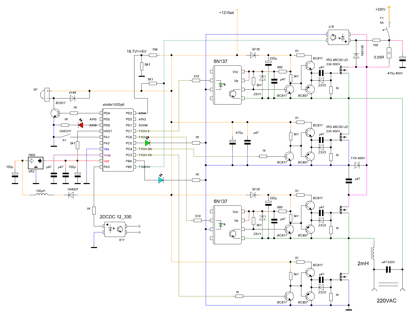

modified schematics for project from message #193
At the first sight that circuit is work. To say the least 40 minutes 20W motor load test is ok (only spwm generation test process programmed)

Last version of that HV spwm modulator with STM8f103f2p6 mcu.
100W motor load test ok, multiple switch off/on mcu&drivers source with +330V on bridge test ok.
