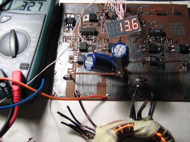

first test of stm8 DC_DC 12_320 converter

test with 100W incandescent lamp ok, with removed capacitor from HV measuring part (it cause voltage fluctuations).

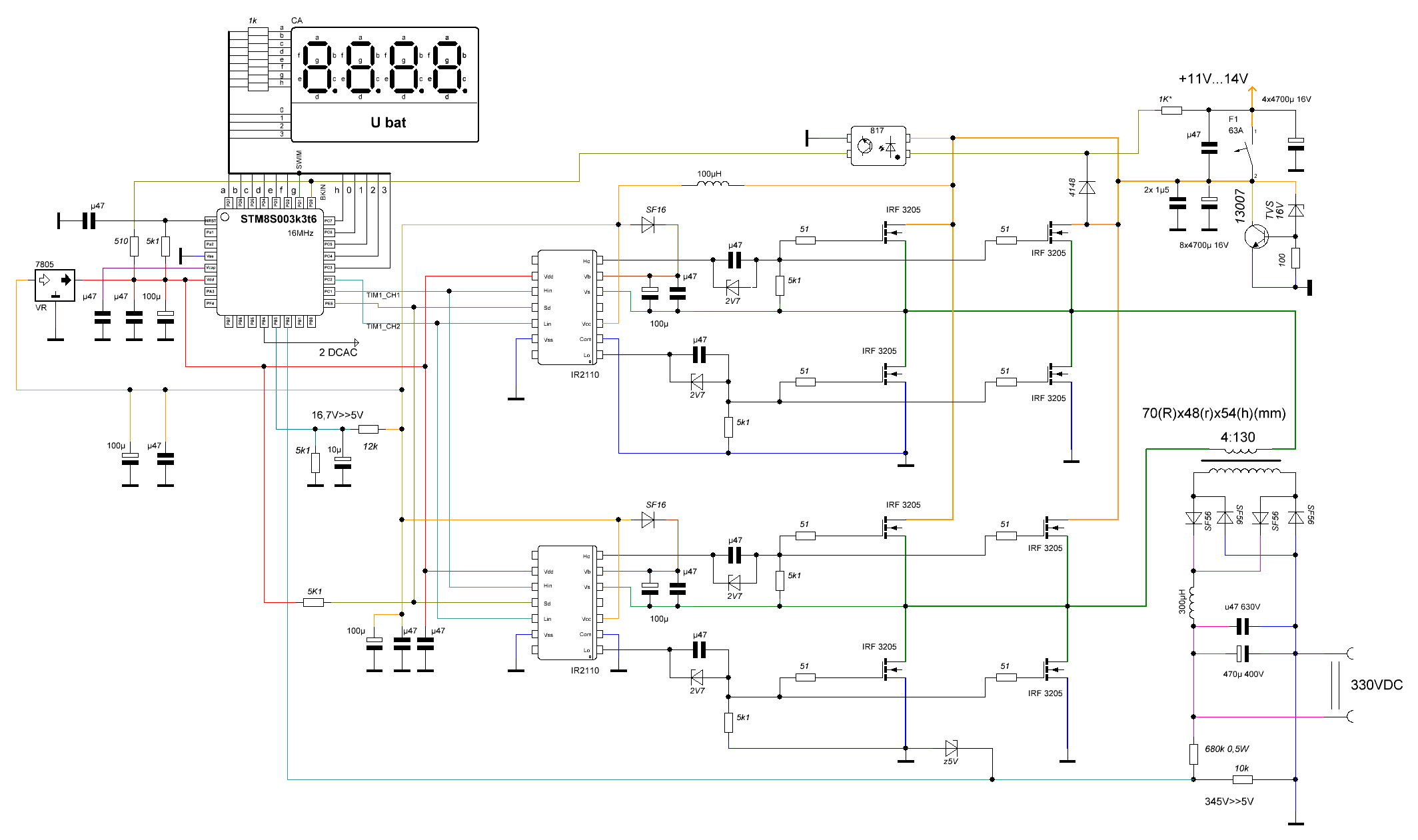

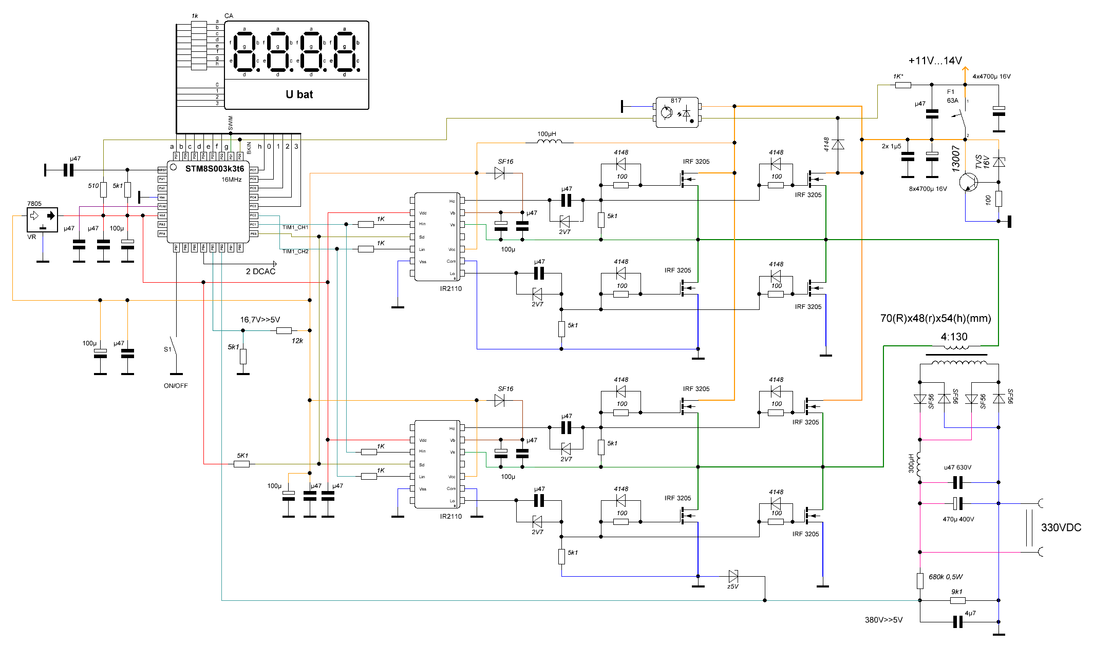

OK, what are using for sinewave generation after this stage (DC2DC)
Would you plz modify the schem in message #218 or #220 for STM8S003F3 because its the only chip available here, and don,t have the tools to modify the code or option bit as I have to program the chip using an Universal programmer.
I will use 2sa1383 2sa0683 for the complementary pair after 6n137.
STM8S003F3 as i know exists only in 20pin TSSOP(or QFN) package so remapping options bits must be programming. But this bits also may be programmed by mcu itself. Well i shall try this.
version with option bits self progrraming

Ok DeepOne, Can you help me design the DC-AC side of this and i pay for it
I want the stm type with ir2110 and multiple mosfets to handle 4kva. i want you to construct it and i will pay for it. we do not have this chip in nigeria talk more of the programmer
IMG_20141023_133530.jpg my dc to dc converter driver and transformer section
I'm not professional and do this only for fun and when i have free time and suitable mood.
Also i think 6N137 optocouplers or HCPL drivers in such application is significally more reliable decision than IR211* chips.
at first sight on such DC_AC converter it's scheme could look as that

if optocoupler is used to drive high side transistor, is not there require independent supply (ground cannot be the same of the main supply and the high side driver supply) to drive?
For optocoupler feeding possible use same scheme as with IR2110.

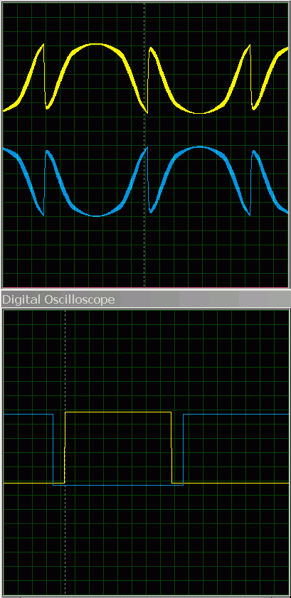

seems hardware deadtime generation is uncomplicated task even for attiny13 )
  • c&hex&proteus.zip
more complicated tiny13 circuit
  • t13_fb_dtg_c&hex&proteus.zip
