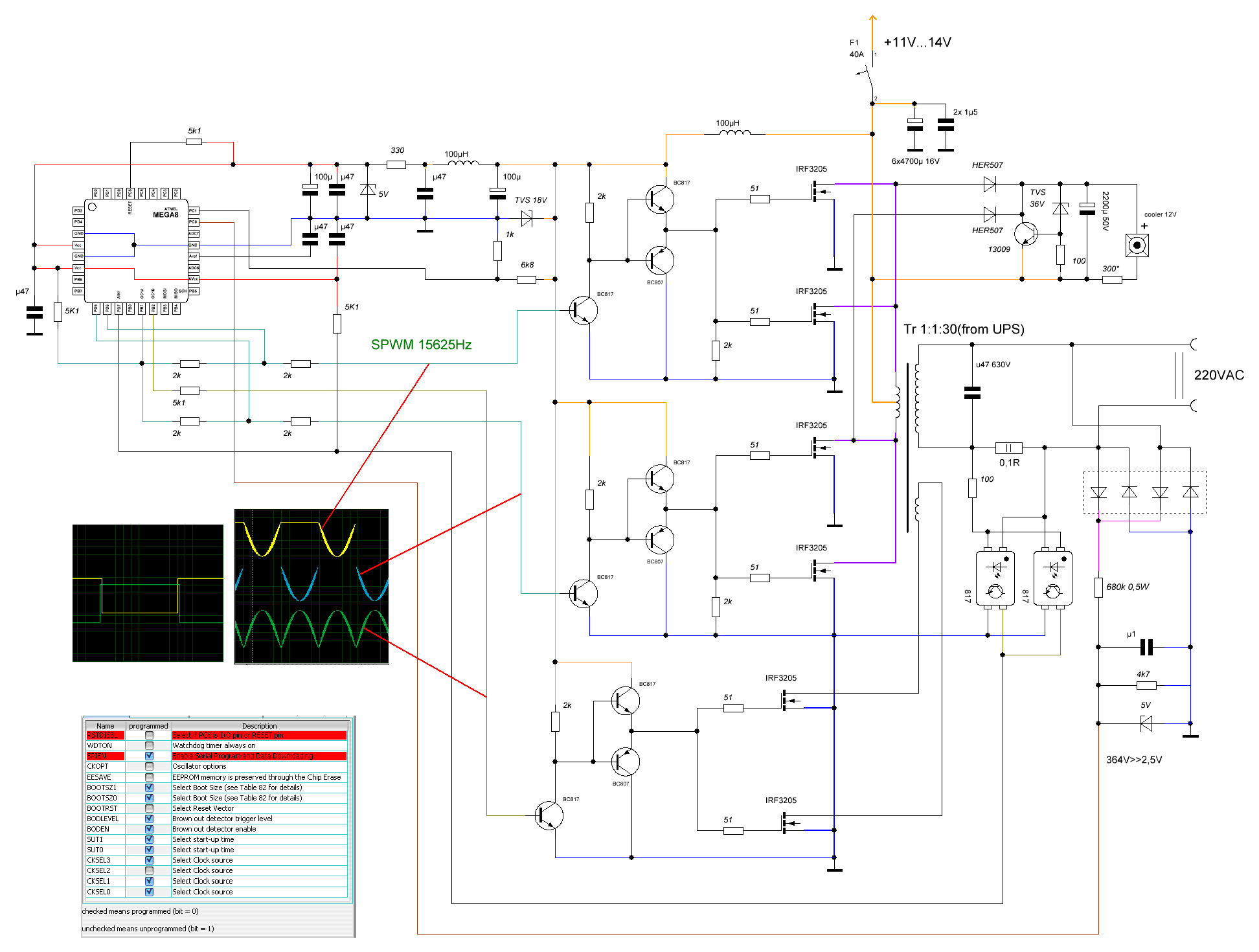

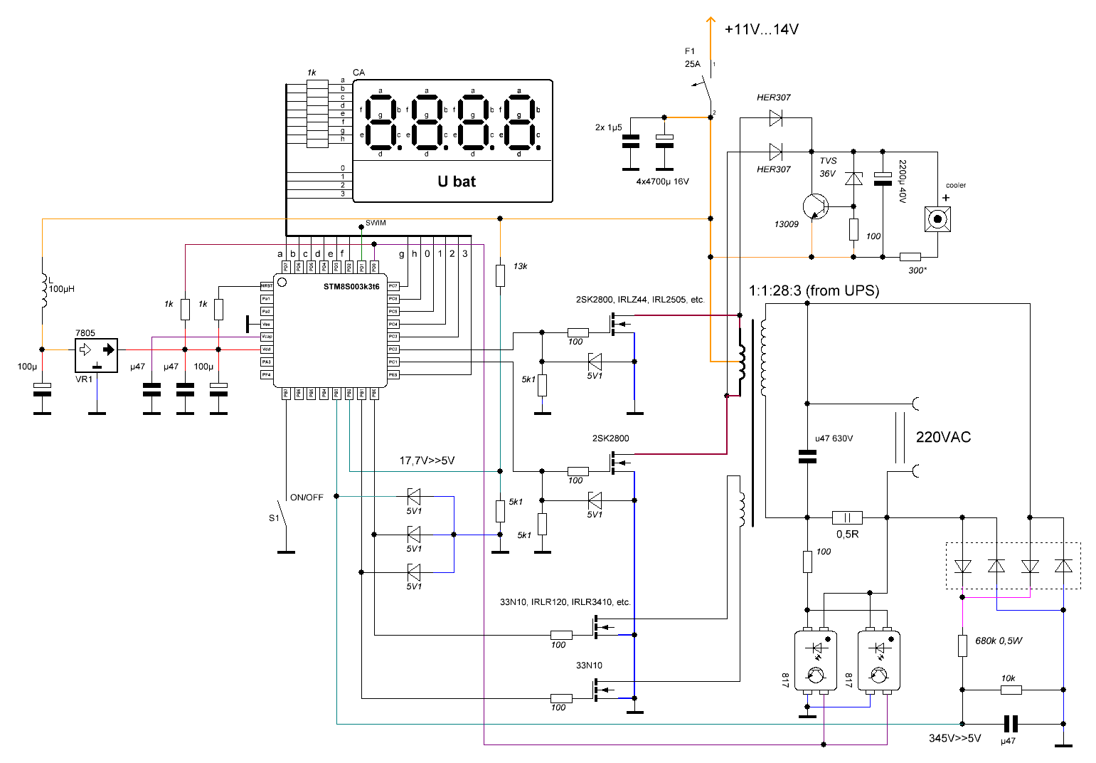

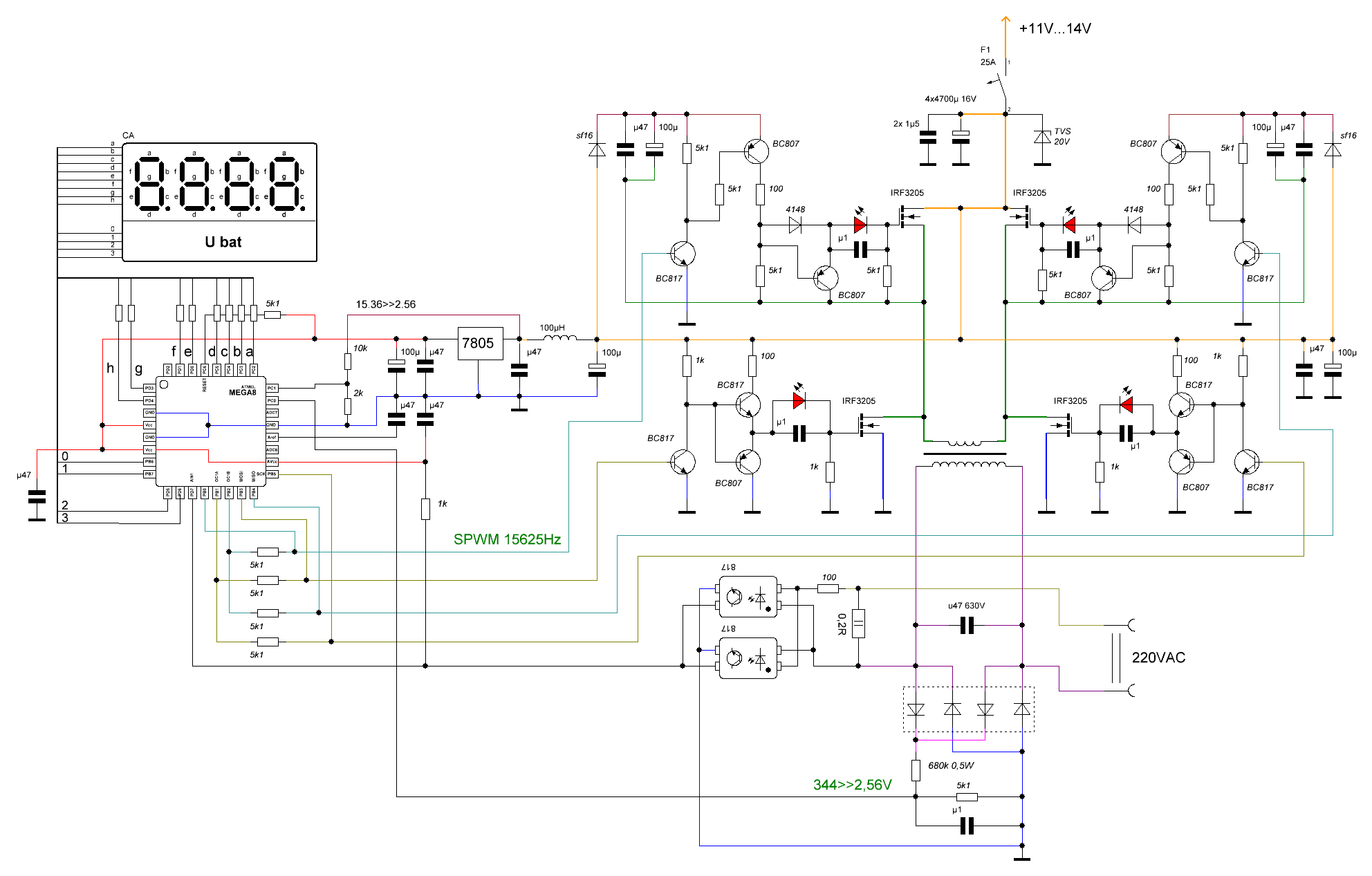

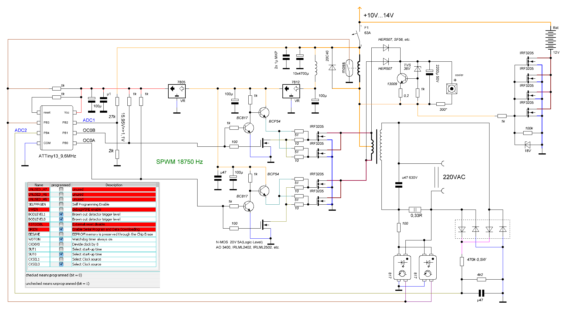

But would you please explain the drive mechanism.
driving mechanism such as in previous version - one half of the bridge is works with spwm while other half has switched off upper fet and switched on lower fet . On following half-wave they are changed by places. Ok, program has mistake in switching mechanism (not unamendable) - because designed for different scheme. But for 6n137 hi-side and bjt lo-side drivers it may work correctly without changes in program.
Did you check this last schematic in Hardware?
And did the upper bootstrap section gets 50Hz H/L logic or 15Khz
I think this is cheap and will work for 15khz SPWM
Is this scheme better than IR2110 or any other dedicated chip based bridge.
only driver part with stm8 mcu
yes, it may work in 50Hz - 30KHz range
no, it is much worse then with IR2110, because power and hi-side driver signals are too bound.
next version with atmega8. not tested in hardware.

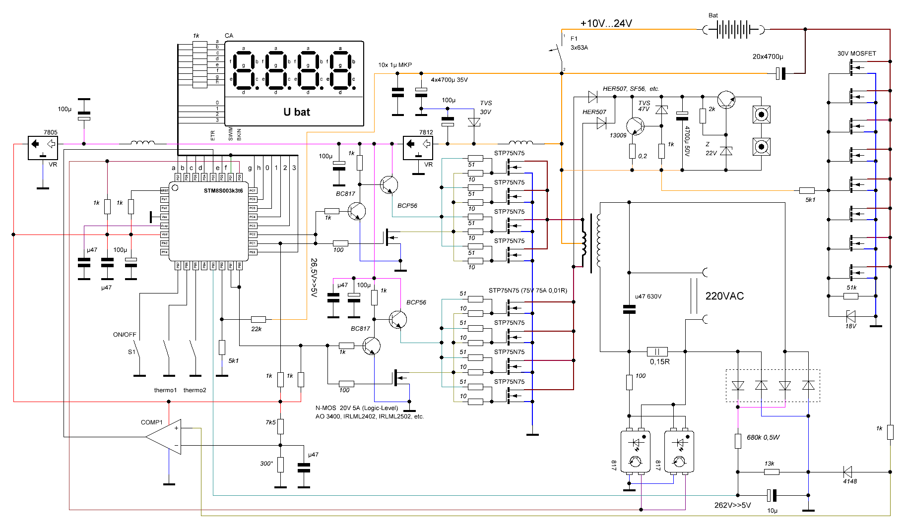

What is the purpose of another winding in the trafo..
and what guage of wire is used for this winding.
I think to try to use 20V winding of the transformer which is intended for battery charging.
That is thin, but may be sufficient for give the road to spared energy.
Why the drains are short to each other.
This will supress spikes generated. Note this channel has inverted input.

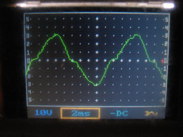

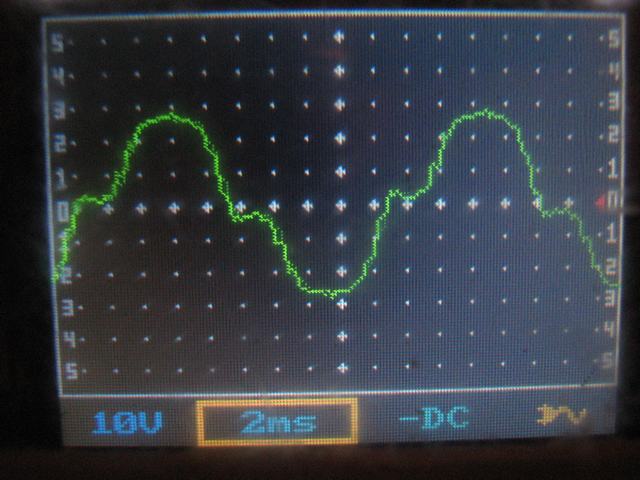

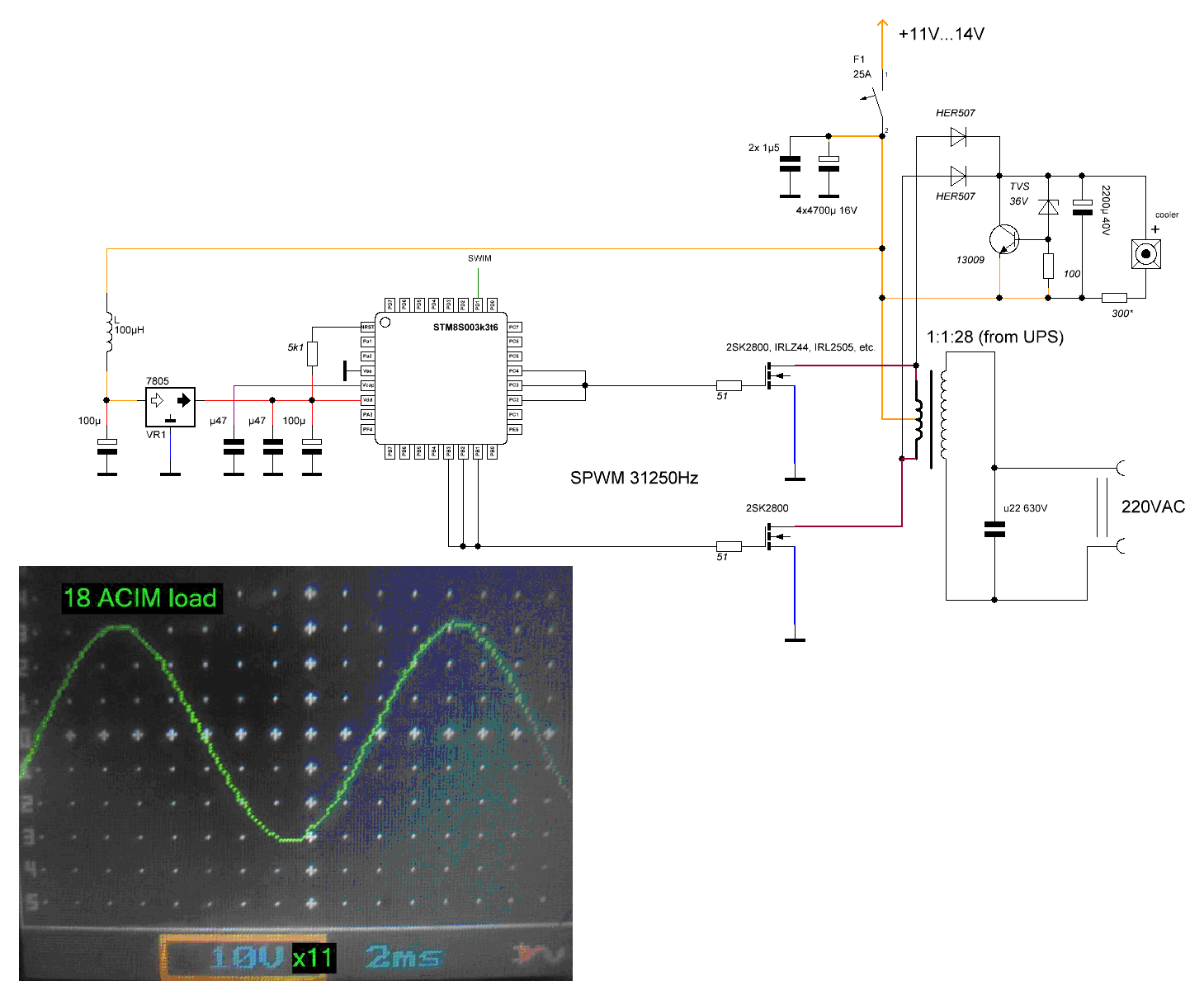

At the first sight last circuit work, with 20W ACIM load.
may be version with stm8 be better )
  • stm8_only_spwm_c&hex.zip
not much better (
  • c&hex_spwm_stm8.zip
also version with STM8. no load current - 1A.

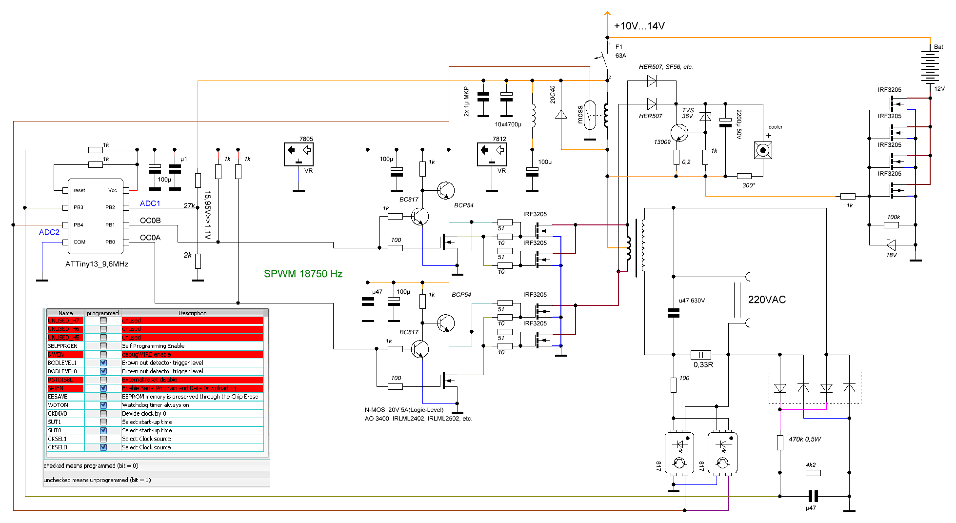

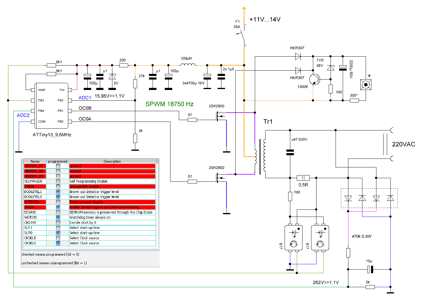

version with attiny13
  • t13_pp_c&hex.zip
more powerful tiny13 )
  • t13_pp_V2_c&hex.zip
The extra 4 fets are for reverse battery protection, but what the logic level mosfet at the gates are doing.
logic level mosfet for switch off power fets.

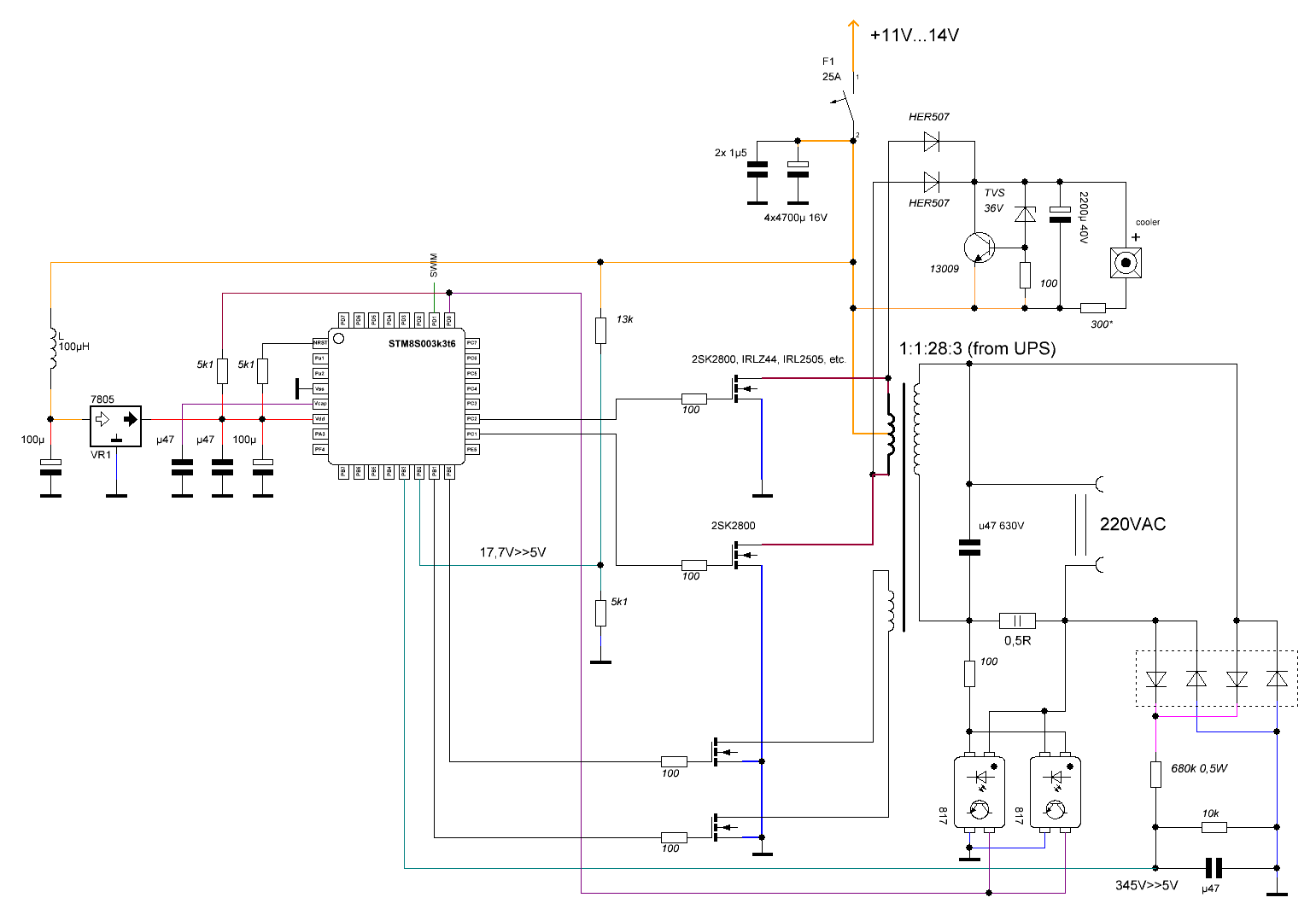

circuit with corrected small mistake -
Why such a wide range 10-----24v supply, transformer also has to be changed.
