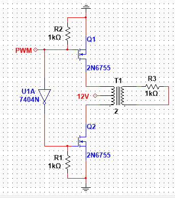

Okay is this circuit right ?
Also, what are the advantages of a triangle wave over square wave as carrier signal ?
No.
You cannot use old-fashioned TTL (74xx series) logic to drive most Mosfets. The minimum output high voltage of the 7404 and for most TTL logic is only +2.4V. The 2N6755 Mosfet barely turns on with a gate-source voltage of +5V and needs +10V to fully turn on as shown in its datasheet.
A "logic-level" Mosfet needs a gate-source voltage of +4.5V to +5V to fully turn on but that is from Cmos logic, not from old-fashioned TTL logic.

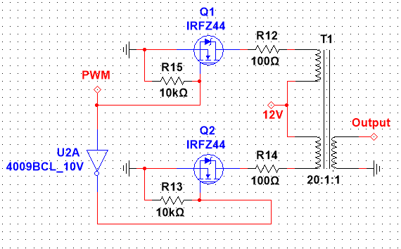

Okay finally figured it out ! The culprit was a faulty centre-tap transformer model (duh)... So now the circuit looks like this and it works fine. But there is one problem. The output wave is just a stepped up AC version of the PWM wave. How to make it look like a sine wave ?
Here's the circuit. Is it alright ?
The PWM pulses are at a high frequency. Use an LC filter to smooth them but pass the low frequency you want.
Why do you have 100 ohm resistors in series with the outputs of the Mosfets? They reduce the maximum output power to only 0.7W RMS.
Your Mosfets without the 100 ohm resistors produce a peak-to-peak output of about 26V then the 20:1 transformer produces an RMS output voltage of only 92V instead of 120V and the voltage will drop as the battery voltage runs down.
