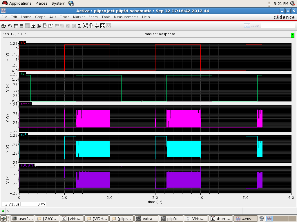

We are using D flipflop logic for implementing phase detector in PLL.But even after reseting, the outputs(up & down signals) of the phase detector are oscillating.Can you please suggest some solutions to this.
<a title="pll.png" href="http://obrazki.elektroda.pl/2262646000_1349847714.png"><img src="http://obrazki.elektroda.pl/2262646000_1349847714_thumb.jpg" alt="pll.png" /></a>
The best way to debug is to use an ideal D flipflop (Verilog A model).
Some capacitance/frequency problem I guess!!!
Apart from the problem, that the asynchronous reset may cause a timing violation (e.g. being too short), some artefacts in the simulation waveforms suggests a serious hardware problem, e.g. the reset spike occuring on the first clock edge. In so far, post #2 seems to hit the point.
Reset signal change when A change. The and gate is not well designed.
