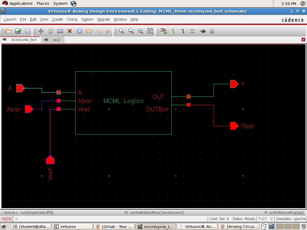

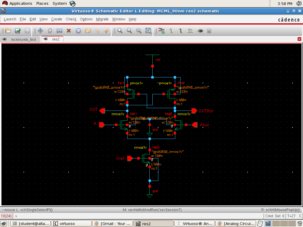

I am doing thesis on Arichetecture of Dynamic Current Mode Logic , so i have to create MCML symbol for it . How to simulate a MCML Symbol and how can be it conneected. i am attaching some pics
this is the DYCML arichetecture
the above schmatic is MCML Inverter and from this i created Symbol as shown below

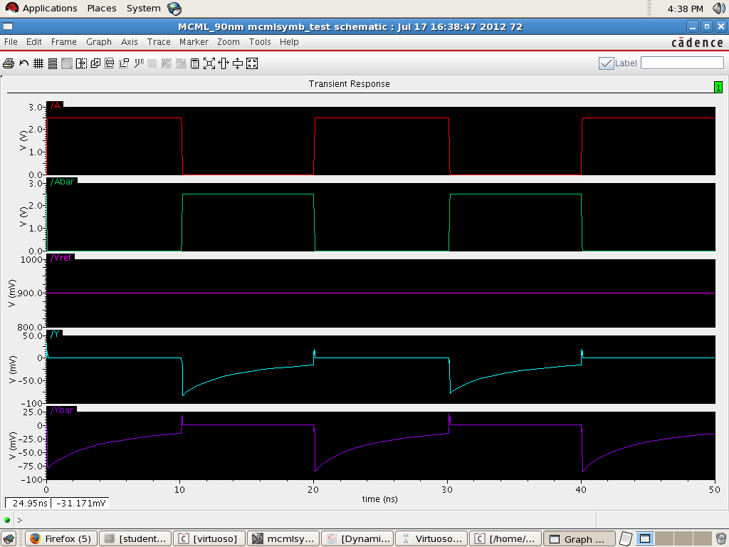

In symbol can we connect pins as in schematic ? or else have to take VPulse as inputs? i am not getting exact result for the symbol ,getting spikes in output .
why like that ,please help me sir

Can I see your testbench? How you connect vdd?
i given vdd 2.5 v, vdc 1.2 v and Vref also 1.2 in stimuli
for symbol simulation why to use VDC,VDD, gnd a seperate circuit ? for my MCML symbol if i use this i am not getting result getting fatal error: the following branches form a loop of rigid branches (shorts) when added to the circuit V4 : p (from vdd! to 0 )
when I see your testbench, your Vdd=1.2V...and you purposely put A/Abar input (=1.8V) higher than vdd?
