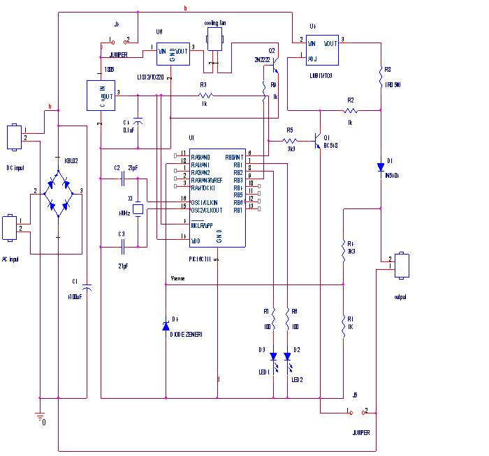

I used PIC16F628A ( no XTAL needed ). LM317 forms a constant current supply switched on and off by a micro-controller . A 5V rail for the PIC is developed through a LM7805 3-pin regulator. T he LM317 will maintain 1.25V between the OUT pin and the ADJ pin. I used a large 5W resistor here to ensure a constant 1.5A supplied. You can select this value as suits your batteries ( charge current should be no less than C/2 where C=battery capacity [mA] ) . Just use Ohms law and divide the 1.25Volts by the current that is recommended for full charge. For example 0.68 ohms will provide about 1.7A ( 1.5A actually because LM317 is limited internally to 1.5A ) and 1.2 ohms will provide about 1A.
"The IN5404 diode ensures that the circuit charges the battery, and prevents the battery running the circuit, should the input power be accidentally turned off! If this does occur with a fully charged pack, the diode isolates the circuit and upon turn on the charger will find the battery peak again and return to a trickle charge after just a few minutes."
"When the transistor is biased on, it effectively takes the ADJ pin to about 0.2V. This means the output voltage of the whole unit is about 0.5V. The transistor is biased on by default, to ensure that the unit is "fail-safe". The PIC can turn the transistor off by shorting the base to ground, and this allows the LM317 to provide a regulated, constant current output. The drive current for the PIC, the transistor base and the transistor collector are all in the order of 1mA which is within the rated range of the PIC and transistor."
"A final feature of the software is that there is a Built-In-Test (BIT) upon power up that effectively tests all of the components except the capacitors (more than 80% of the components). During power up, if no battery is detected the output is turned on for 1 second and the voltage checked, and then the output is turned off. "
The bridge rectifier and capacitor should produce about 1.4 times the AC RMS input. So if using a 10VAC supply, the main rail should be about 14VDC. . At least 2.5V is dropped through the LM317, current sensing resistor and output diode. Also check that the 5V rail is regulating properly. LM317 will need to be mounted on a heat sink .
"If you power up the charger with no batt in it will display E A . "
" - If the switch is closed ( RA5 is low ) then the charger will skip the discharging faze.
- If the switch is open (RA5 is high ) the charger will perform as usual ( discharge and then charge ) "

Hi Dexter.
In this period, I built your battery charger and it works as expected! Now I can discharge and charge from 1 element to 4 batteries without any problem.
I have only a little problem with the RS232: using a scope, I can see that the PIC send data every second, but on PC I can see data only every 3 seconds more or less (it is not constant: sometimes I can see every second, rarely every two seconds and more often every 3 seconds).
Is it normal? If not., have you got an idea what's wrong with my circuit? Can it be a problem with the calibration of the internal oscillator?
Thanks again for sharing your circuit
Regards.
Luca.
atiny15
Your circuit is fine.
Data is send thru RS232 every second only when measured voltage has changed or every 3 seconds if data stays the same. This way is easier to plot data by omitting unnecessary points.

Hi ! I want to build this charger, but, unhappiness, I do not found 1.25 ohm resistor or 0.8 ohm. Can I replacing them with 1.2 ohm (@ 5W) respective with 0.78 ohm (parallel of 1 ohm and 0.56 ohm, @ 5 W each) ? Can I use diode BY550-800 instead 1N5904 ? Thanks in advance for Your support ...
delta v battery charger circuit
Hello fratello
I think you can use that resistors values, no problem.
I'm using 1R5 and 0R94 and the charger works fine.
About the diode: Is necessary a drop voltage of 0.7v under diode to circuit works. Verify voltage under diode with a digital multimeter, 0.6~0.7v i think are OK.
Ps: Parallel 1 ohm and 0.56 ohm result 0.36 ohm, just recalc.

One more question : in the pcb file is one R=0,75 ohmi, instead 1,25 ohmi in schematic. Why ?
...b.t.w. You are wright, my mistake : 1/R eq = 1/R1 + 1/R2...stupid me...
All the best !
battery charger schematic pic
Hello!
the 0.75 ohm in pcb i think is for use the maximum current (1.5A).. 1.25 ohm is for 1A.
I use 1.5 ohm resistor and get 0.86A, it's good for me.
