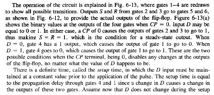

hi,this is regarding edge triggered ff setup time described in morris mano.
it says that D input must be maintained constant prior to the application of pulse and if it changes with pulse at zero the output of nand gates (1 & 4) changes.
but what is the issue with the statement - though the output changes the outputs at nand gates (2 & 3) are at 1 only.
so how does it conclude setup time violation.
i have uploaded images.
please clear my doubt.

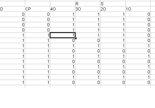

Assume your cuircuit was in state shown in first picture, and then both CP and D went high simultaneously. If you draw out what happens labouriously, you'll find that R and S will not settle to a fixed vlaue, they'll keep toggling. See picture. Every line corresponds to the output of the gates after one gate delay.
In a real circuit, they will settle to some indeterminate value.
However, if D had been given after the rising edge of CP, this would not happen.
