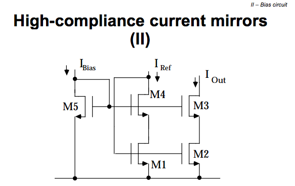

In a cascode current mirror I designed, the power supply is fixed ie total voltage across drain- source of both cascode and current source transistors are fixed. At the moment, I have 300mV across cascode and 320mV across current source. How can I distribute mode Vds across current source without changing power supply? Please help

By changing the W/L ratio.

If M1 is current source and M4 is Cascode (My circuit https://obrazki.elektroda.pl/1809141300_1375520932.png)
To increase Vds of M1, increase L1, which means I should increase W1 to maintain W/L ratio
To decrease Vds of M4, I should decrease L4, which means I should decrease W4 to maintain W/L ratio
Over drive for cascodes are just 70mV now. Do you think I should increase this further? Because in corners I observe they swing to values as low as 40mV
To increase overdrive of cascode, i should increase its Vgs-Vt, which means increase Vgs, which means decrease W/L of the bias transistor which generates bias voltage for cascode

The whole point of cascode is to protect the current mirror from Vds variations & once cascode goes to linear the current source become susceptible to Vds variations -->Larger current change between the branches.
this is right. that is why cascode is used in current mirror
Re: Explanation of DC operating point parameters
... To increase overdrive of cascode, i should increase its Vgs-Vt, which means increase Vgs, which means decrease W/L of the bias transistor which generates bias voltage for cascode
Right. And additionally you can play (simulate) and change the W/L ratios of M1 & M2 or M4 & M3 .

I have one more question. Is there any way I can reduce the drop across the cascode transistor (Vds without changing its W/L or not touching the Vdd?
Please let me know.
The only way I'd know is to use lower Vth transistors for M1 & M2 (e.g. native NFETs with Vth≈0V .. few 100mV), if available.
