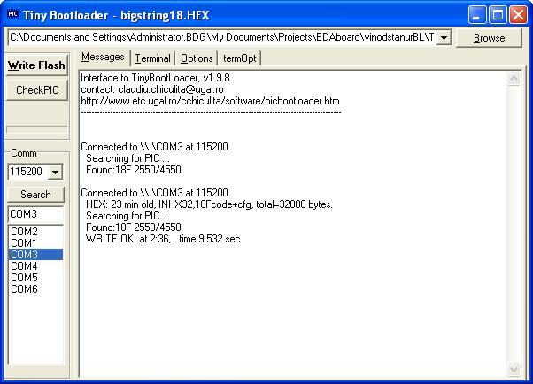

Attached are the zipped tiny PIC Bootloader project directory ported the PIC18F2458/2553/4458/4553 family.
The code now assembles without warnings or errors.
I've tested the bootloader using a PIC18F4553 and the test program, "bigstring18.asm."
The crystal frequency used was 4MHz, so you will need to change the CONFIG PLLDIV from 1 to 2, if you are using an 8MHz crystal.
CONFIG  PLLDIV = [COLOR="#FF0000"]2[/COLOR], CPUDIV = OSC3_PLL4, USBDIV = 2
Also you will note the Tiny Bootloader GUI App recognizes any of the PIC18F2458/2553/4458/4553 series as its PIC18F2455/2550/4455/4550 counterpart.
This is due to the lack of source for the the GUI App, which matches a code issued from the bootloader to a PIC device string which is outputted in window.
One issue to be aware of is once a program has been downloaded into the device, the bootloader waits for approximately 1 second, according to the code comments, before jumping and executing the program loaded in the flash. Which means you must click the "Write Flash" Button to download a new HEX file, immediately after resetting the device.
This is trickier that it sounds. You may want to change this "feature" to fit your requirements.
