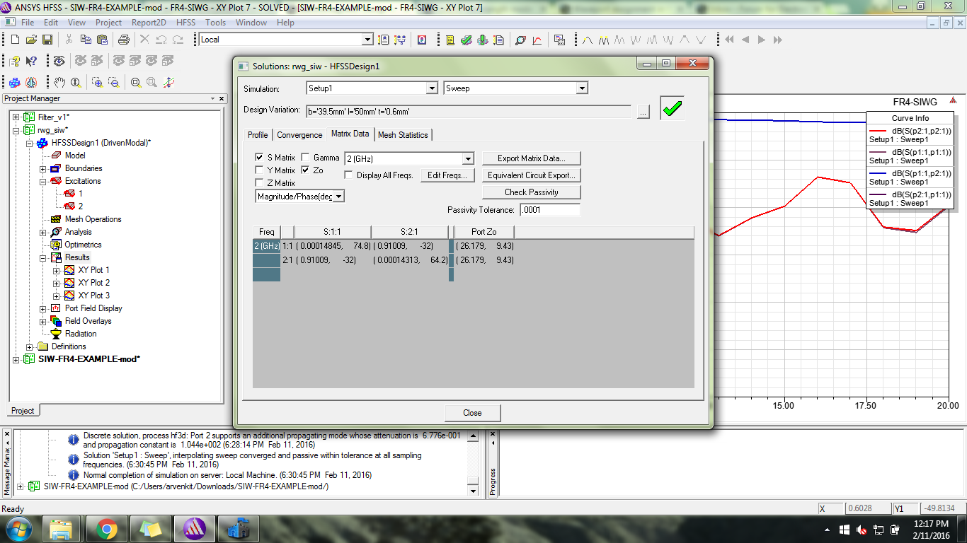

I am trying to simulate a rectangular waveguide and find out the characteristic impedance. What is the port Zo which is given in the Matrix data? Is it the same as characteristic impedance. Is there a scaling factor that I am missing?
port Z0 is the characteristic impedance of the structure. In order to find the correct value of Z0 take care that renormalize to 50 ohm check box isn't checked.
yea.. I am exciting only TE10 mode and the field plots confirm that. for the dimensions and frequency i hve chosen i should get 270 odd ohms where as i see 26.179 ohm.. this is where i m getting confused..
There are a few strange things I notice in your attached image - is b (= 39.5 mm) the width of your SIW? Using a dielectric constant constant with FR-4 = 4.4, the cutoff frequency should be 1.8 GHz, so I guess the mode should be supported at 2 GHz. I'm not sure why the characteristic impedance would have such a large imaginary component (~10 degrees?). Can you post some more information, such as the setup and scattering parameters, or perhaps attach the file?
The SIW filter has a =53.74mm which corresponds to a cutoff of 1.5GHz with a Rogers 4350 substrate of dielectric constant 3.66. Please find attached the hfss design file. It is a 3rd order chebyshev iris filter that I am trying to design. I get the filter response, but I am not able to undersdtand what the port Z0 is

Hi arve9066,
Your simulation setup, as well as the results, seem to be correct.
Characteristic impedance is not uniquely defined for non-TEM modes -- many textbooks will use the "wave impedance" definition, however, this doens't take into account the geometrical parameters of the waveguide (which HFSS does). To convert between the two, simply multiply the HFSS result by a/b.
That's something I did not know. Thanks for that information. Is there anywhere in the HFSS documentation I could find this?
At 2GHz which is above the cutoff frequency, the port Z0 given by HFSS is 3.96. Multiplying with a/b (53.74/0.6) gives me 350 ohms around. For an equivalent rectangular waveguide filled with dielectric of er=3.6 is, I remember I should ve got around 270 ohms.
So when I calculate the Z parameters from solution data, they are normalized to the Z0 which is the port Z0 displayed HFSS times (a/b). Am I correct?
There's more ambiguity still to come. The way in which characteristic impedance is calculated for non-TEM modes can also vary depending on your choice of equivalent "voltage", "current", or power. Search the documentation for "Calculating Characteristic Impedance". Unfortunately, I don't think there's any documentation on the various plane-wave or other definitions. This isn't really talked about much, even in the literature...
Yes, converting from S to Z parameters requires using the characteristic impedance values.
