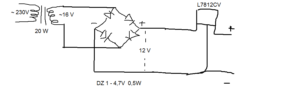

Thx, is it schematic good? I have a question: after diode will be 4,7 V or 11,3V (16 - 4,7) ? Please answer that.
Your arrangement produces 4.7V.
By the way, the zener diode will fry. You must include a safety resistor.
The resistor will have about 10V across it.
can i put voltage stabilizer before zener diode L7812CV ? but where i should connect it?
If you use a regulator such as 7812 family then you don't need a zener diode.
However the buzzer is not fussy about its supply voltage. You need not go to the expense of using a regulator IC.
I believe a 12V buzzer should work fine on 10 to 15 VDC, unregulated.
some like this?
But why i need voltage stabilizer after bridge when it make voltage 12V ?

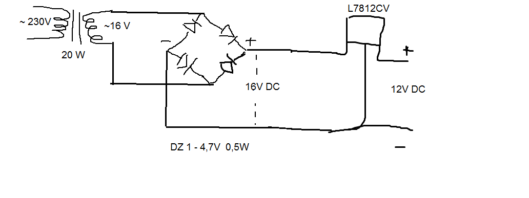

Sorry i ' ve mede a mistake in schematic. After bridge will be too 16 V but DC , after stabilisator wil be 12V DC i think.
Where you wrote a label saying 12V, you would need a filter capacitor. The value depends on how great the load is. 330 uF is reasonable for your buzzer and led.
The diodes are plain diodes. They need to be rated for minimum 23 V reverse. You have them labelled as DZ (zener), 7 V.
I don't need zener diode now, i have stabilizer and schematic. It is good?
THERE ISN' T A ZENER DIOD, A DESCRIPTION IS BAD (DZ)
You are making progress.
You still need to add a filter capacitor across the supply rails where it is labelled 16V DC.
To be correct, the transformer secondary should be labelled 12 VAC.
Thanks, but how much capacity i should do?

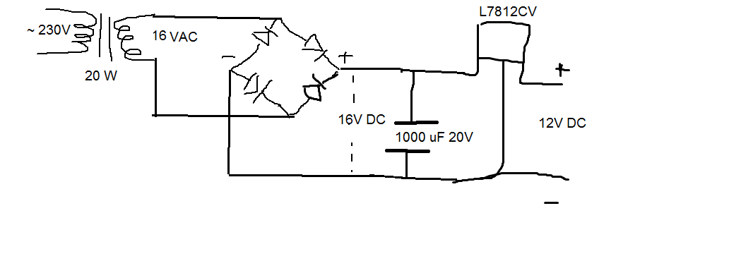

This is schematic

I' ve found this in the internet. Can you improve my schematic and send to me? I know about resistor before led but i' ve forgot about put it.

What type of buzzer takes only 5mA at 12Vdc ? piezo electric with built in oscillator.
What is this current? 12V/5mA = 2.4mA This is adequate to turn on high brightness 5mm LED of any colour. But if you want separate controlled current no problem, just less efficient. By the way, you can power this off the line without any transformer if you asked in the first place..
Consider LED voltage drop like a battery and you are charging it, so the series resistor will depend on the voltage difference.
Now the transformer rectifier of 12Vac with a bridge and cap will produce more like 16V with no load or 1.4x 12V. with a certain amount of ripple.
So buzzer will be a little 40% louder or so and let choose RED LED resistor for 20mA for a drop of 16-1.6V= > 14.4V / 0.020A = 720Ω with power = 14.4*0.02= 288mW so choose 1/2W. Since it will be a tone frequency modulated by 50Hz/60Hz times 2 , it can be made louder and cleaner with a storage cap. if RC= 20mS then C= 0.02sec / 720 Ω or ~ 7,000uF @ 20V. (This neglects the ESR of the LED which is around 10Ω @ 20mA )
Overall it is clearly an inefficient design with large RC components, but does what you asked for.

Why after the bridge, cap and stabilizer there will be 16V ? Stabilizer doesn' t make 12V DC ??
How i can make 12V DC ??
Please correct my schematic
