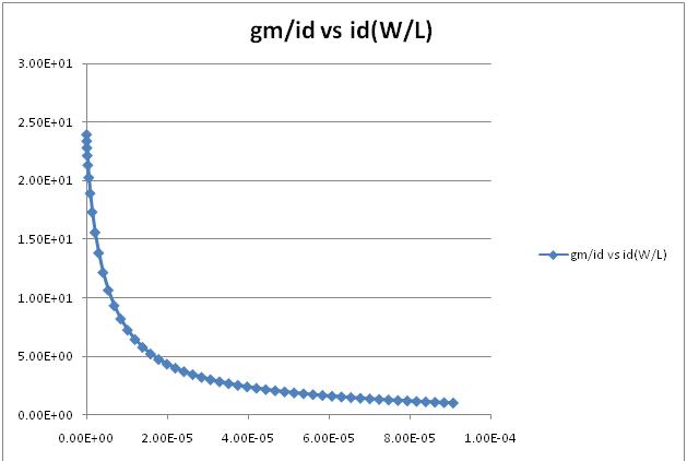

@erikl:I'm attaching my gm/id vs id/(W/L) plot. If I choose a value of 10 for gm/id then my corresponding value of id/(W/L) is 72uA.
Ravinder: From your plot I get a value id/(W/L)≈7µA for gm/id=10 , not 72µA.
With bias current as 45uA(considering slew-rate requirements and power dissipation) my W/L should be less than 1 and with this value of W/L i will never achieve a gain of 100.
No. For 45µA you'd get a W/L=45/7≈6.4 .
It is 7.2E-005(72uA)

ohh sorry i will recheck my graph

Only in strong inversion, not much in moderate and weak inversion, s. the 2 pages from David M. [Binkley]'s book "Tradeoffs and Optimization in Analog CMOS Design" (180nm process; separate plots for nmos & pmos). View attachment Binkley_gm_over_Id_for_diff_L.pdf
With gm/Id=10 your mosfet is still working in moderate inversion (IC ≈ 7).
