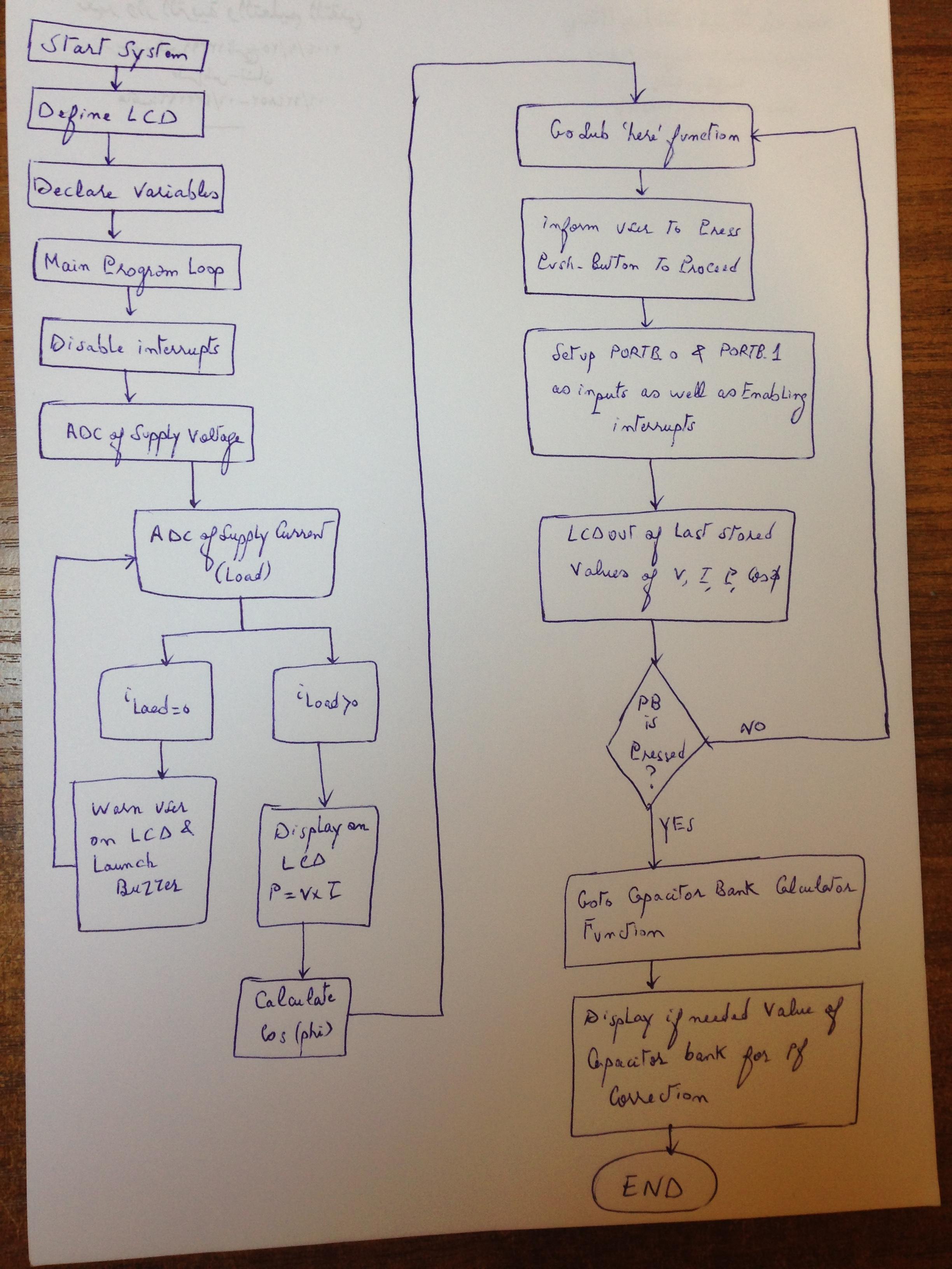

Perhaps this problem can be solved by making an ISR for the pushbutton?? Whenever pressed directly go to the desired loop, but what I fear of is what if the user presses this button at the beginning of the program, but can this be solved by marking a flag at almost the end of code such that even if the user pressed it, before a flag is marked 1 for example no ISR routine will make effect because its if/else condition were not satisfied?
My recommendation: Draw a flowchart (only a draft will do) and automatically you will see if there is a problem or not.

	Endif
The problem is if the user presses the push button, before 'here' function took place, that means before the intflag is set to 1
Also there is a physical problem with HD74S86: when connected to circuit even if from another supply (7805 voltage regulator fed by a 9V zinc battery) the LCD don't show a word. If you deplug it from its source, the LCD shows back again characters as supposed, why?
Here it is in another way:
1) The interrupt code for the push button is running great, but the problem is when pressing it when intflag is not set to one, like if pressed at the beginning of the project, the code stops at the last place it was executing
2) Sometimes when placing the XOR circuit that serves for power factor measurement in the circuit, the LCD stop functioning by not showing any character, this problem is solved by un plugging the XOR from the total circuit
Thanks
Isn't BASIC the most wonderful tangle of criss-crossed code!
The 74S86 problem can only be the current it draws, no matter what it's output voltage is, the circuit should still function. The 'S' series of 74 logic gates is for use when extremely short propagation delays are needed but the penalty is high current consumption. A 9V zinc battery may not be good enough to power even a single 74S86 as it could drag the 9V low enough that the 7805 regulator stopped working. You need at least 8V available at the regulator input pin and a 75mA load may be enough to pull the battery below 8V. If you can change it to a 74AC or 74ACT device it will draw far less current and also give better output voltage range. If you have to keep using the 74S86 try tieing its unused input pins to ground to ensure it remains stable.
The software problem is to do with Oshonsoft again. It only allows one 'Resume' statement in an ISR and you have code that may never return from the ISR if the innermost 'If' statement returns false. It is also very bad practice to use delays inside an ISR as it blocks further interrupts occuring.
See if you can restructure the code so the interrupt sets a flag then immediately returns ("resumes"). Then check the flag in your main loop of code and execute 'capbankcalc' if the flag is set, resetting it afterwards so it is ready for next time the switch is pressed.
Brian.

What if I Disable High in the main program loop, and only enable it in the here function where the intflag is set to one?
Hi
Can the instructions immediately after the "goto" lines ever be processed?
Klaus
No they can't - but even worse, after "Goto capbankcalc" the program reaches the end, it never even gets to clear the interrupt.
Khaled, I'm not sure it will fix your problem but instead of "Goto" try using "Gosub" and at the end of the "capbankcalc" routine, use "Return" instead of "End". It will return the control to the ISR where it was called from instead of "falling off the end of the program". I still think the answer is to let the ISR notify the main loop that the button was pressed but do all the decision making in the main loop and not the ISR.
Brian.
Hello,
@betwixt
It worked, such that only if the user presses the push-button it redirects to capbankcalc loop, by disabling all interrupts, except just before the 'here' function.
If a user presses the push-button before asked from LCD, nothing happens and program functions as it should be, only when a "Press Push-Button to continue" is there on LCD, its press is accepted.
Still, I've used Goto capbankcalc function, in the ISR and it is also working good for the moment.
Here is a brief explanations for what I've done to correct push-button issue:
1. Placed a Disable High in the main program loop, and Enable high right after 'here' loop. [DIDN'T work]
2. Deleted Disable High in the main program loop, and Enable high is now right before 'here' loop. [DIDN'T work]
3. Placed these right before 'here' loop, and made Enable high within this loop:
TRISB = 0x03
    T1CON = 0x24
    INTCON = 0x10
    INTCON2 = 0xe0
    INTCON3 = 0x48
    ADCON1 = 0x0f
[It worked!]
I've recently got the 74HC86N used as XOR gate, I will connect it instead of 'S' series of it, and feedback with results.
Too many thanks!

I've had a quick look at the code and there is a problem with the flow.
Minor problem:
set up the PIC before using it, move the "gosub setuppic" to the top of the program just after main:
Major problem:
The stack is out of balance. Consider what happens when the ISR is called, you check if it was from the switch, clear the interrupt flag then jump to 'capbankcalc' without returning from the ISR. It leaves the return address from the ISR on the stack and also leaves the global interrupt bit disabled. There is no way it can reach the 'Resume' statement to finish the ISR properly.
I suggest a flow chart is drawn so you can see all the possible paths the program should take and ensure you never leave a subroutine or ISR without passing its 'Return' or 'Resume' first.

Here is the flowchart:
[P.s There still other 'flows' that must be taken into consideration, the following flowchart is for what's done at this level]:

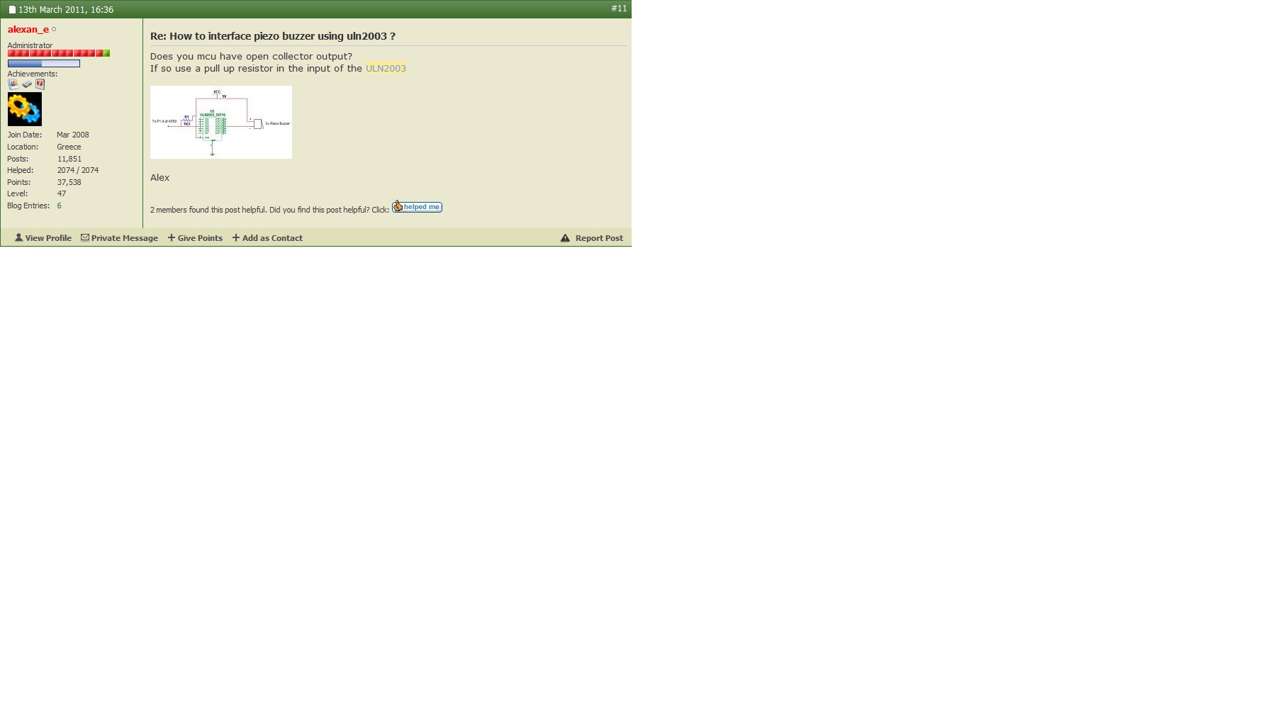

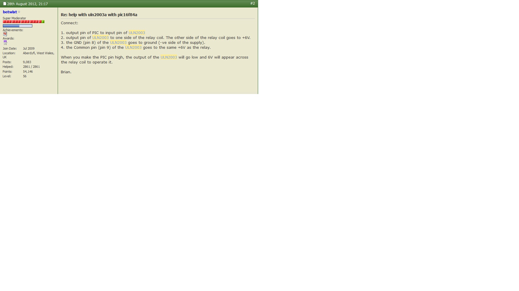

Here's what a ULN2003 circuit should be, according to one of your old posts:

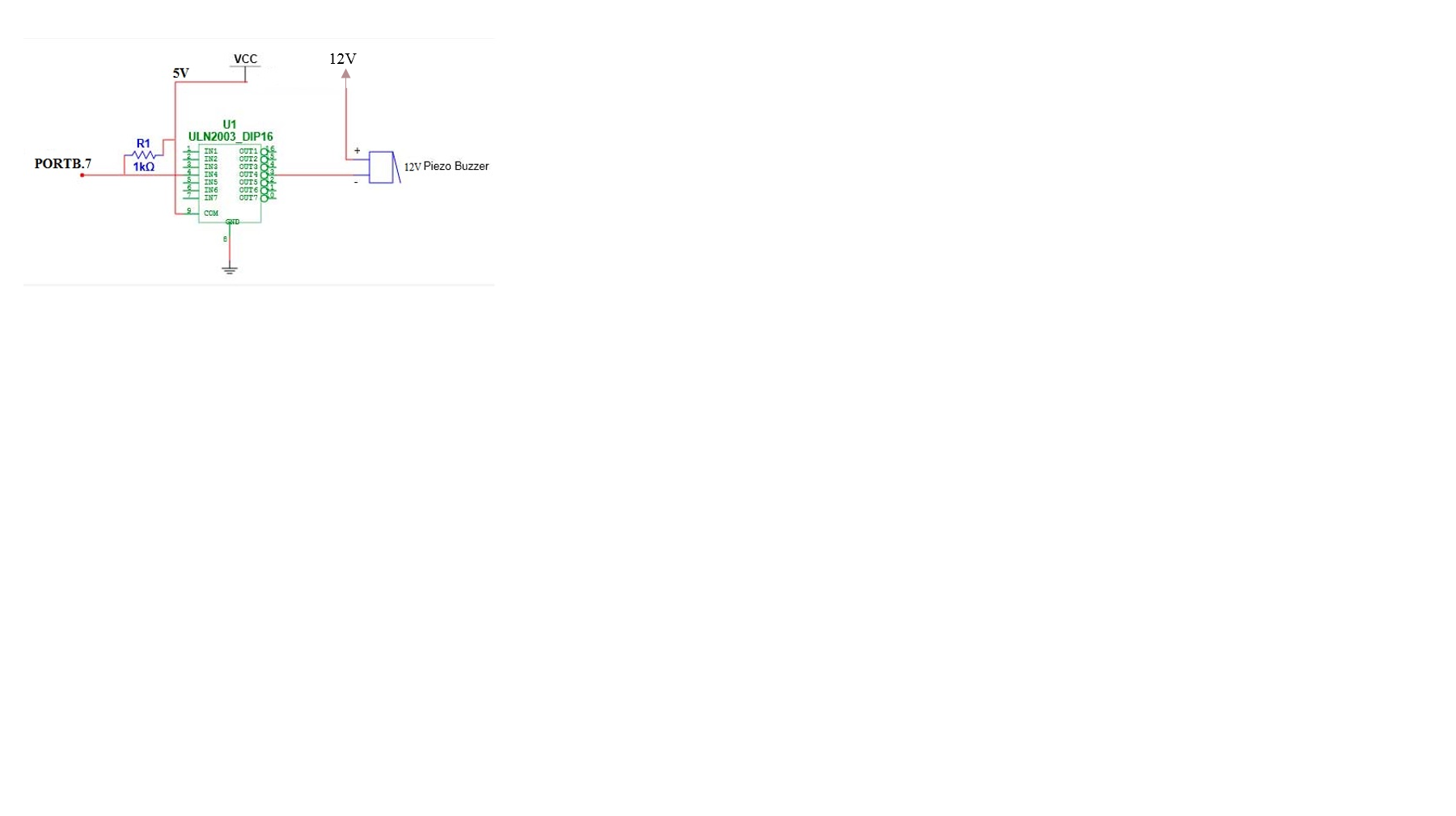

Your instructions in circuitry connection, coincide with alexan_e diagram:
So for a 12V piezo buzzer, the connection would be like:
This is to turn HIGH whenever load is disconnected.
Do you have any concerns about ULN2003 circuitry? I also have a problem for 'no load' coding, what I want is, to flash CONNECT LOAD, and launch buzzer for 3 sec ON, 5 sec OFF, until user connects load, it automatically turns LOW buzzer, and go to ADC measurement for load current, but using the code I wrote (bad code) even if user re-plugs the load, the code is still stuck at "CONNECT LOAD" LCD statement.
Thanks

The ULN 2003 circuit will not work as shown I'm afraid. All the ULN2003 (and ULN2803) has inside it is a bank of transistors and some protection diodes, the internal circuit is duplicated 7 times (8 for the ULN2803) only for convenience. With only one buzzer as the load, you could use a single transistor if you wanted to, emitter to ground, base to the port pin through a 2.2K resistor and collector to the buzzer then 12V. There are two problems withthe design you show, the first is that no pull-up resistor is needed because the PIC can already drve the ULN2003 directly and in any case it already has internal bias resistors, the second is the buzzer will probably work all the time because there is a path for current to flow through it even if the input to the ULN2003 is low. The problem is caused by the protection diode in the ULN output pin, there is a diode from each output and they are all connected to the 'COM' pin. As 'COM' is shown connected to +5V, there is a path from 12V, through the buzzer then the diode to the 5V rail which leaves ~7V across the buzzer when you really want no voltage across it at all. If you stay withthe ULN2003, remove R1 and connect the COM pin to +12V instead, that will make it work.
I'll take a close look at your flow chart later and see how it corresponds to your code.

The 12V that I intend to feed the buzzer from, is the output of the bridge rectifier after the 220/12VAC. Since the supply voltage can reach a 230VAC, the secondary of the transformer can reach to almost 14VDC.
What is the voltage regulator name, that could output a pure DC voltage of 12V, even if its supply is not +2V bigger than the output voltage, like the LM78 series?
Hi
A rectified and capacitor filtered 12 V AC signal can reach up to 17V DC. (12V x 1.414 ) ... subtract about 1.4V for full bridge rectifier.
So you should rather expect up to 20V DC.
Klaus
