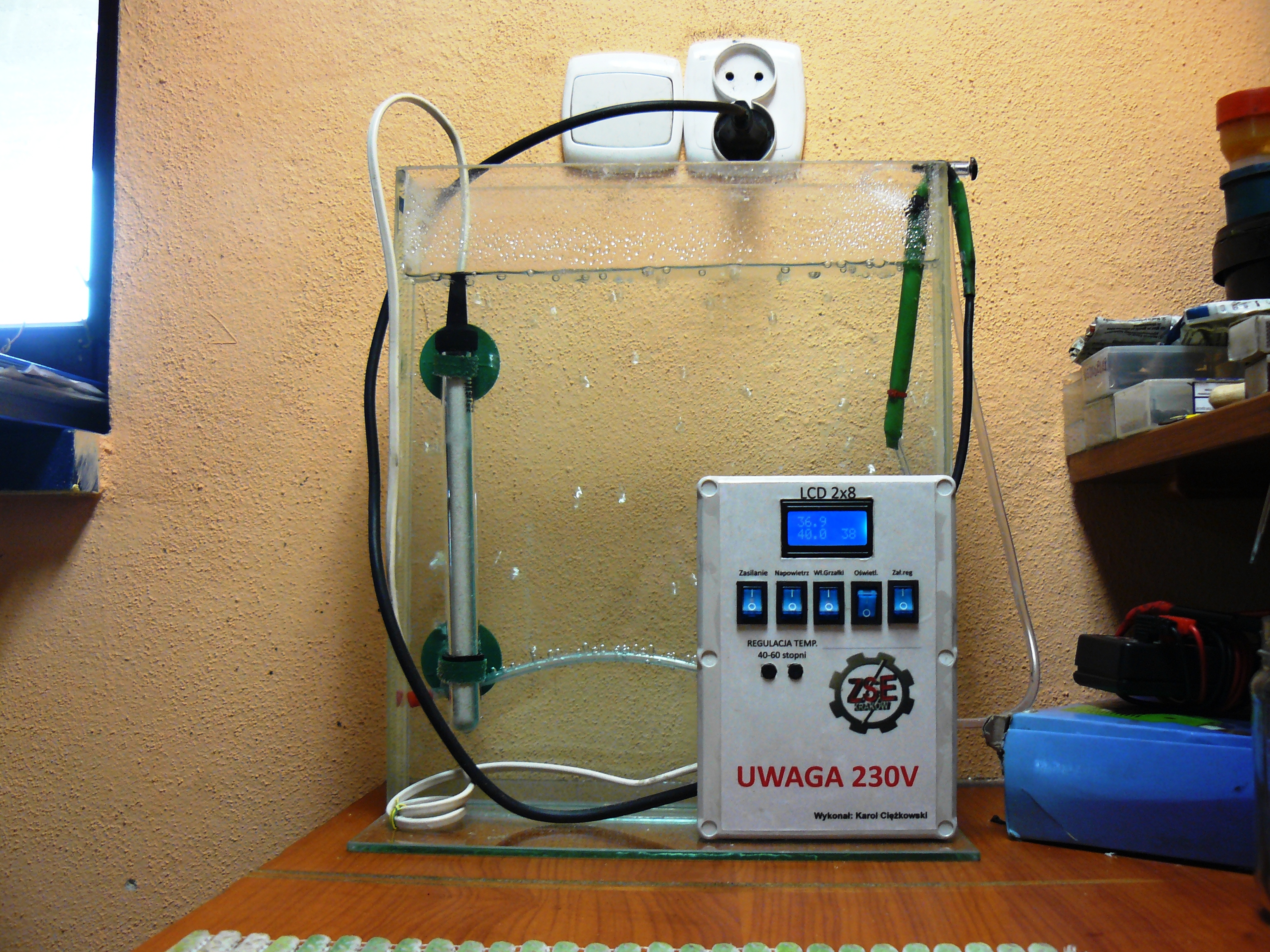

PCB digesting machine 30x40x3
Executive elements:
  • 150W heater without thermostat
  • Elite 800 pump
Presented here device is extremely useful in most electronic workshops. The dimensions allow you to digest many sizes of PCBs. It is also equipped with adjustable temperature.
Aquarium of this digesting machine was made of glass and glued with silicone. High quality of the silicone and professionally made gluing are important to the long-term usage without leakage. Regulator, pump and all the cables were closed in a housing. The number of switches on the front panel can easily be reduced.
Time needed for the digesting machine to heat 4 liters of water to 40 degrees Celsius is approximately 15 minutes. If you use a 200-300W heater, that time will be shorten.
Additionally, you can make a lighting of the device in order to even more facilitate the usage.
