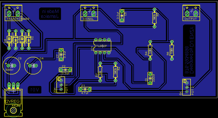

Modern opamps have good high frequency response. If your TL072 is feeding the capacitance of a shielded audio cable that feeds the power amplifier then the capacitance of the cable on the output of the TL072 causes it to oscillate at a high frequency. Add a series 100 ohm resistor from the output coupling capacitor of the TL072 to the cable connection to fix it.
Did you measure the output DC voltage of the opamp? Is it half the supply voltage?

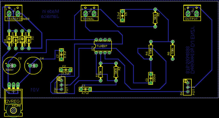

Wouldnt the negative feedback be the 330k resistor from pin 2 going to pin 1? You probably didnt realize that its going to pin 1 also.
As per your drawing, pin 6 appears to be the output...
Pin 6 is tied to pin 7 is doesnt go anywhere else I told you that pin 1 is the output just trust me on that.
In the software you can connect 2 or more lines without having to physically connect them all you need to do is give the lines the same name, in my drawing pin 1 is connected to c1 and the 330k is connected to c1 also

Ok, Also how exactly would I calculate the gain of a preamp like that? The 330k resistor on pin 2 going to pin 1 and the 10k going to ground would set the gain. So would that make the gain be 34 in my case?
Correct. 1+ (330k/10k)= 34.

Ok good so having a gain of 34 is that considered a high gain? ALso the check you told me to do on the preamp checking the output voltage in dc when there is no signal and you said it should be half the ac voltage, I ac tually didnt get any reading it was 0v dc and it still worked after connecting signal, even with the signal I'm still not getting any dc out so I dont know if its my meter not being able to read it but its dc so it should be able to.
The Chinese amplifier has an input sensitivity of 1.6V. Then with a gain of 34 the input to the preamp must be at least 47mV which is easy from a laptop.
The DC voltage at the output pin1 of the TL072 dual opamp should be half the supply voltage.
