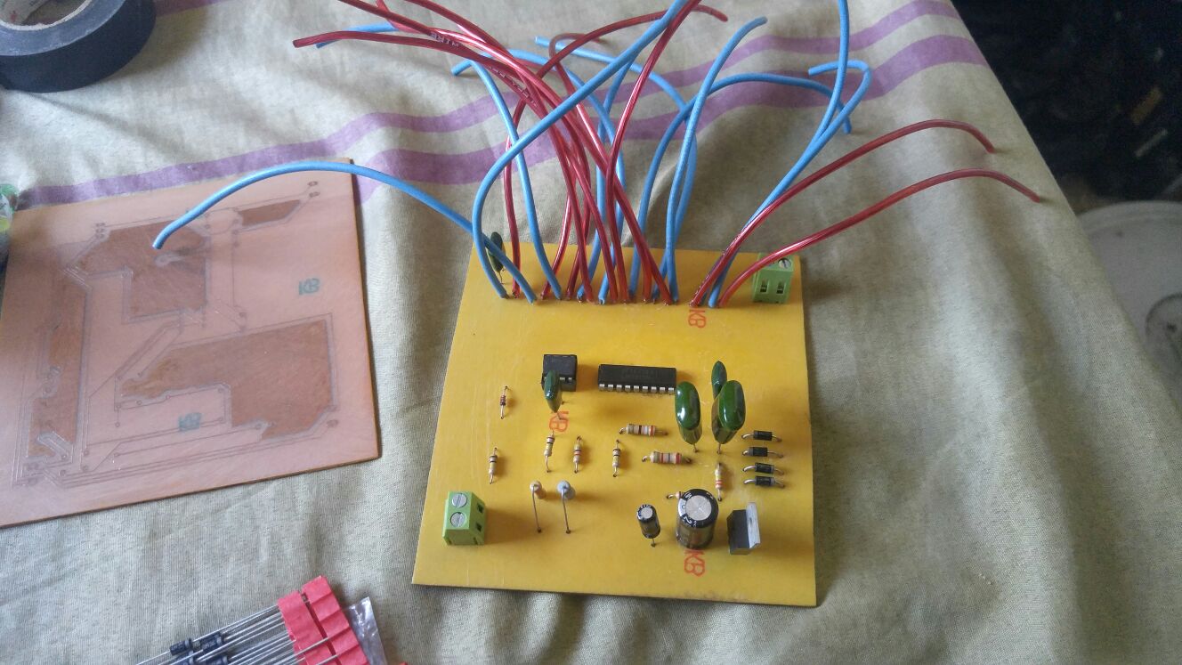

I build the VU meter I didnt get the time to assmeble them both I am not sure if I am having issues with the pcb I build but once I apply power to the vu meter 1 green led comes on the a yellow light and then I think 2 red lights go on and off then 1 red led stays on for the rest of the time without any effect from the input, Im new to board making, if this issue should happen is there anyywhere you could pin poit that would allow it to behave like that.

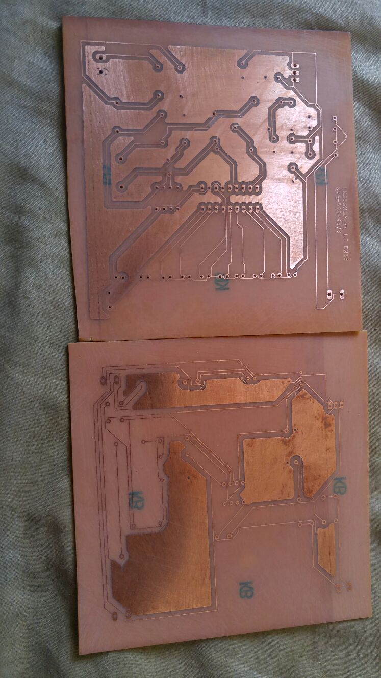

these are the boards.
I was doing some testing today and realized a couple open circuits either when the circuit has been printed or in the design the traces where directed some of the pads properly, ill troubleshoot some more.
It is difficult to look at your schematic with a PIC and the PIC pins instead of an LM3915 and the LM3915 pins.
It is also difficult to look at your pcb that has absolutely nothing labelled.
It appears that the input pin #5 of the LM3915 is not connected to anything and is floating, picking up interference.
I cannot see any pin numbers on the LM358 dual opamp on the pcb.

Sorry about that I havnet reach the part yet in building t start labling, I tried it before and one looked messy and one was very faint but since I have the drawings I wouldnt need them. I found 5 open circuits including pin 5 so far the issue seems to be on my part so I have to work on that some more and give an update at a later date, work is hectic this week for me and probably next week, I will fill you in soon.
