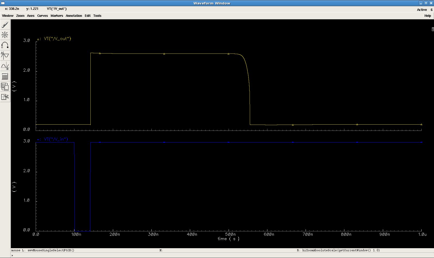

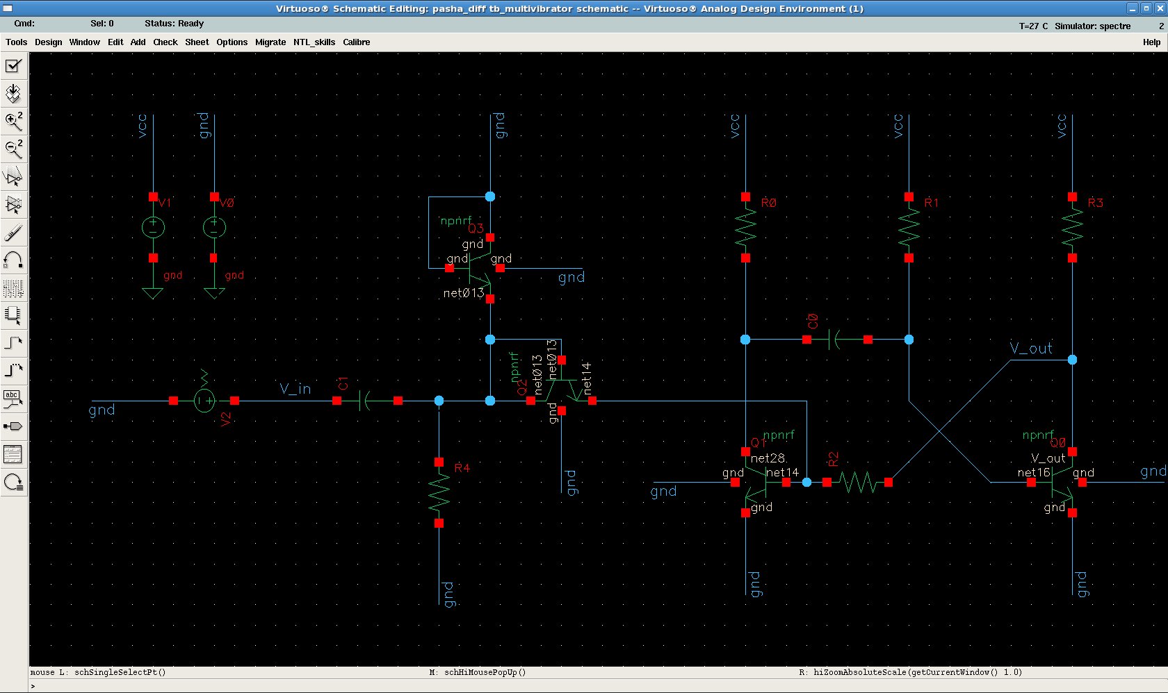

Hi Guys,
I tried my hands in simulating a simple one shot monostable multivbator in Spectre. I am getting the wrong output for some reason. Is it because the trigger signal is too short? I put it at 1us pulse width. Even when I changed it to 10us, I still don't get the correct output. I tried to vary the RC element which should determine the Tau of the output waveform, to no avail. Can you help?
I was using this as reference: The One-shot Monostable Multivibrator
Thank you!
Al

V-driving the drain of that leftmost transistor means that transistor
does nothing but waste current. The whole thing is a wireball to me.
If I was doing this for a product I'd spend the extra transistors and
do a foolproof state machine (SRFF driving discharge switch, SRFF
driven by trigger & discharge and reset by ramp top).
Maybe the IN node wants a different form of drive.
Hello
This is my circuit with slight modifications
The input and output waveforms are the following:
So everything works fine)
Regards.
