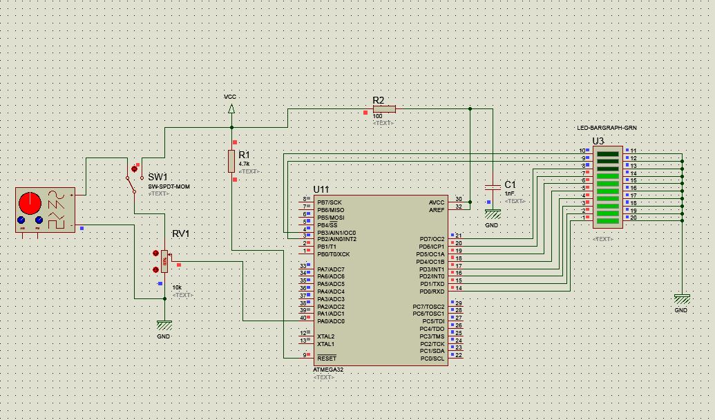

how to make a peak hold fall down effect using c language.

that is the question.
hardware: 10 level LED graph,atmega32
a simple peak level indicator in c language is easy,just read ADC and plot the maximum value.
then, how to make a peak hold fall down effect .
You have to OR the output with another variable which holds the peak value as LSB to MSB values..
what about a slow fall down effect ?
If you already have the code for other operations then post it I think i can modify
----------------------- LOGIC -----------------------
Run a background timer of (say) .25 sec, that will give interrupt for every 0.25 sec..
after that there will be the variable which will decrement(shift) for every interrupt and also load the value of ordinary peak detector if it is more than the new variable..
in while do as i already said...
atmega-32 single bar graph LED Proteus File
  • AUDIO_LEVEL.rar

i follow the similar logic without timer.
