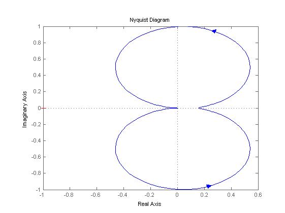

Is this graph indicating stable system or unstable system?

Actually I have plotted this for the function
e(½*t) * sin(2*pi*t)
This should mean that the system is unstable. But from the nyquist plot I am not getting it as stable. What I have read is this- If the amplitude( which is the radial length in the Nyquist plot) is greater than 1 then the system is unstable but what I get is less than 1.
Here's image
Thanks in advance.
