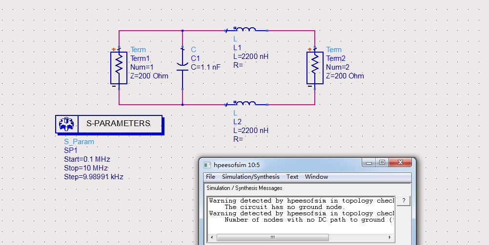

thank you ,your pdf really helps me a lot ,here is what i do,but i dont know if am i right
there is some warning,should i ingnore it?

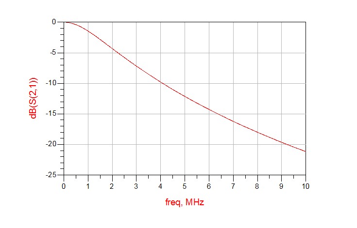

and my result is not the same as the pdf'image,on pfd'image s21 is -40dB on 10MHz,my result is -20dB on 10MHz,so i feel like i didnt do it the right way,please help me

i did it just as pdf told me.
and the pdf'image shows there shoud be -40dm on the freq of 10MHZ as below:
but when i simulate it by ads as below:
https://obrazki.elektroda.pl/2698684200_1357723796.jpg
the result is different,only -20db at 10MHZ
PLEASE,HELP ME,thank you
Your ADS schematic has 2.2µH instead of 22µH.
