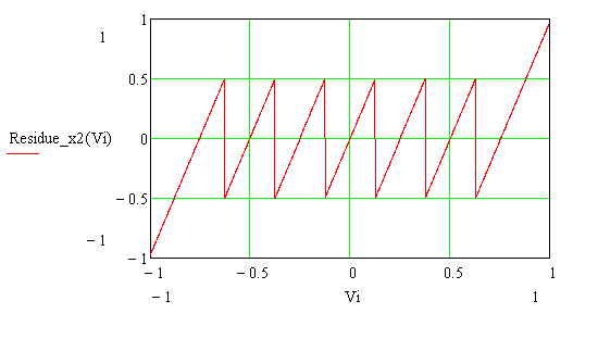

I have a function in mathcad which will have multiple broken points.
I need to shift the curve to make them continuous again. For example, the shown graph will need 2nd segment by 1x, the 3rd segment by 2x and so on.
However, I don't know how to do it in Mathcad. If any one can help, that will be great. Because Mathcad is still kind of more visualized than Matlab so that I can do it in a more intuitive way in Mathcad.
Thanks,
Neo

Neo - do you mean this in the same context as, say, phase unwrapping?
If so, one performs a recursive solution:
U[0]=V[0]
for i E 1..N
delta = V - V[i-1]
delta = delta+1 if (delta < -0.5)
delta = delta-1 if (delta >= 0.5)
U = U[i-1]+delta
or something akin to that - brute-force summation of unwrapped differences
Let us know if this is what you had in mind
