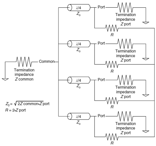

Here you can find how to do the connections and the equations for line impedance and resistor values, for a 4 ports Wilkinson divider.
hi,vfone
thanx for your help,can you give me some examples without the resistor R,because my design don't use the R!
