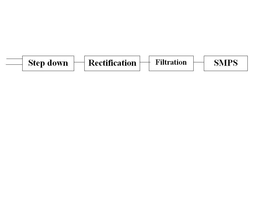

I want to design a switching power that has 15V,DC and 1ADC out put, and in put is 220V, AC and frequency is 50 Hz, any schematic and pdf is so appreciated, mean while is there any software that can design this power for me ?
first u need step down process......
then rectification .......
after rectification you need filtering .....
after filtering you get dc......
now some swithing for switching power .......
main block diagram is like this...
step down , rectification and filtration all processes design depend upon current you need at the output....
you can add a voltage regulator at the output may be 7815 .
for switching you can use LM5576/or 4052
this figure may help..
