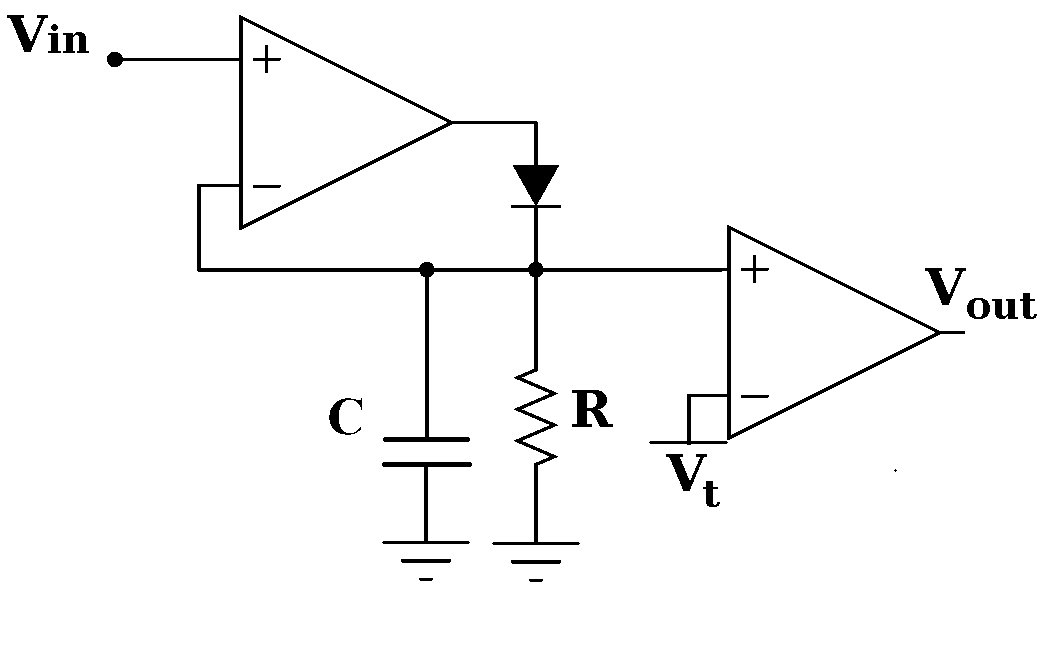

Hi Everybody,
for a university project I have the need to check for the presence of a trigger-in signal in my apparatus.
- The signal is a digital clock with a variable frequency in the range 1MHz - 50MHz.
- I can detect this signal either from the negative output of a LVPECL XOR (Low level at 1.6V, High Level at 2.4V) or from the output of an opamp (Low level at 0V, High level at 200mV)
- I just need to generate a high/low level to send to a PIC microcontroller in case the trigger in signal disappears.
Any Idea? I thought about a superdiode (opamp+diode) plus a tuned RC circuit and a comparator in the end (see picture).
SInce space on my pcb is a problem I would like to find a simpler circuit without the use of two opamps!
Thanks :)
Gianluca
I'd suggest a simpler digital transition detector (like an XOR,
with clk to one and delayed clk to the other input) to drive a
"reset switch", and your RC network tuned to maybe
2-5uS time constant, and a Schmitt buffer after it.

Thanks for the reply!
Dick's idea is good but the component count is pretty much the same as mine plus to delay the clock I need a long trace on my pcb or a delayer and that means a lot of space required.
Karesz, if you read my description more carefully, I won't feed the LVPECL signal directly to the PIC, that won't work as you suggested.
My collegue suggested an alternative using a BJT: connecting the base of a PNP BJT to the LVPECL signal, its source to a Vdd voltage through a resistor and its drain to a capacitor.
In this way the BJT behave like a square-wave current generator. Dimensioning the R and the C I can create a voltage ramp on the capacitor and using the ADC or the comparator on the pic I can check if a certain threshold it crossed.
Once the Vt is crossed I can discharge the C through another pin of the PIC and a diode.
I tried to simulate the circuit with Vdd= 3V, R = 1k and clock signal between 1.6V and 2.4V. If I put a resistor on the drain everything works fine but with a capacitor I can't get a voltage ramp!
Any idea?

I like the idea of the current generator but I can't get it to work, at least on my SPICE simulator. I am quite sure I don't need a base resistor since the current is fixed through the emitter resistor and the base voltage.
The problem is when I swap the resistor on the collector with a capacitor. Instead of getting a voltage ramp I get a more or less constant voltage. What's wrong with my configuration?
Obviously, if anyone can suggest an easiest way to implement my clock detector... ideas are welcomed!

hi Gianluca,
You can load/switch from PECL output over a serial Schottky (Cathode on ECL out) a serial resistor-capacitor between Vcc & GND_ C is to GND & i.e. 1..2K to Vcc...Common point of Cathode/R & C is output too.
Discharging must be possible with a switched parallel resistor on the C.
K.
