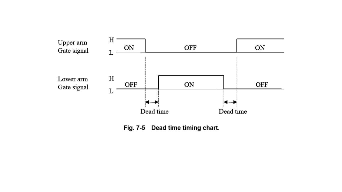

today,i checked the output of low pass filter in DSO
peak to peak voltage is 2.45v without 100k pot
nw i want to make 2 pulses( a,a^) using lm339 ,
the output of low pass filter fed into - terminal of IC1A(1st comparator) and +ve terminal of IC1B(2nd comparator).
nw i try to design the value of voltage divider , which 3 resistor R1,R2.R3. across +3.3v and grnd.
Let the voltage V1 at the middle point of R1 and R2 connected to the +ve terminal of IC1A(1st comparator).
and the voltage V2 be between the resistor R2 ,R3 be connected to - ve terminal of IC1B(2nd comparator).
see the ckt.
Design of resistor value is depend on dead time.
in order to make exact complement of pulses (a,a^)
R1 = R3, R2= 0.
nw V1=V2.
Is it correct ???
am waiting for you reply.
regardz
mobin
Dear FvM
My project is completed upto low pass filter section.
nw i wana to move to lm399 section. to generate two logic pulse (a ,a^)
Nw,i faced 2 prblms
1) is this modifed circuit is correct ?
In orginal circuit ,i noticed that -ve terminal of 4th & 6th comparator is shorted each other not connected to the voltage divider or -ve terminal of 2 nd comparator.
2) Design of voltage divider ( value of R1,R2,R3) ,considering dead time. how much dead time will consider ?? 3us??
Regardz
mobin
