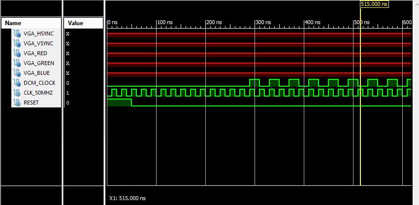

Now, I am not sure about how to implement reset for all the other registers in the design, since they are driven by the DCM clock output.
If the RESET signal pulse lasts for a period shorter than what it takes to assert the locked signal, (which probably will be the case because of the OR gate at the rst_in), the registers will never be reset.
always @ (posedge clk)
begin
   if (LOCKED && !STATUS[1])
	begin
           //GOOD TO GO
	end
	else
	begin
	 //RESET
	end
end
Does the always @ (posedge clk) trigger even when (LOCKED && !STATUS[1]) isn't high? If so, why does the simulation show everything inactive until the locked bit doesn't go high?
Will I have to use an async RESET to reset my registers?
