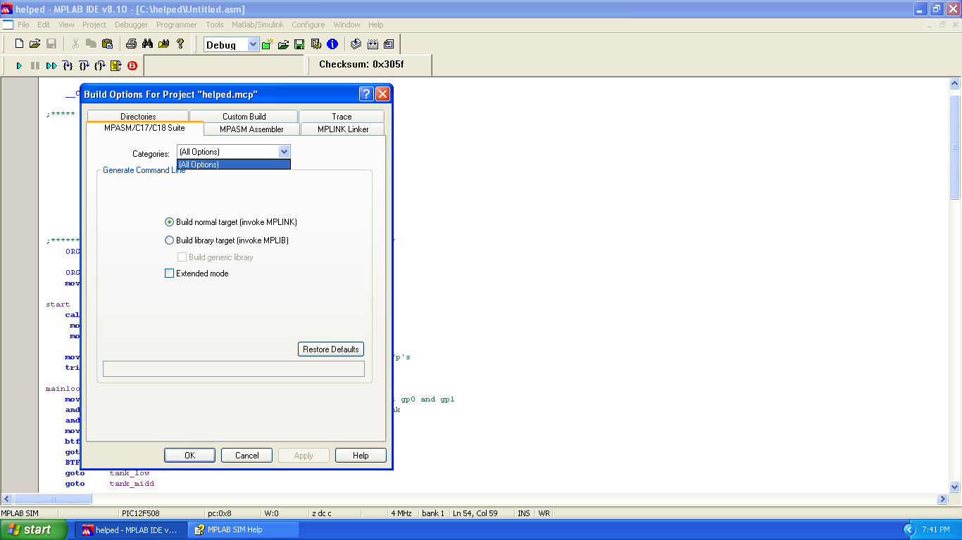

am using mplab v8.10 and i dint find those project paramets,relocatable mode and absolute mode.. can u please tell me how to change it exactly??
the actual problem is wen i simulate and step into each instruction,the declared register doesnt decrease or something,but it continues to loop around and never skips wen its zero..can i see the user registers anywer wen i am simulating the code?
Mplab 8.10 should work ok.
With your project open - Project, Build Options, Project,folder MPASM/C18 Suit - select - generalte Absolute code - Apply
Here is your code, I have put the delay call as the first intruction and it runs ok.
Using Mplabs Simulator the rest of the code runs around your main loop and does not call the delay - unless you are using inputs or another simulator ?
Edit - rather than single step though the delay, use the breakpoints as I have shown ( right click on the line ) then you can Run over the delay and stop at the end to continue with single step, You can do that on any section of code, but limited to typically 3 breakpoints .

hi,
in the build options i din get dos absolute code. below is the image wat i got and by the way The problem is solved. Thanku all..
