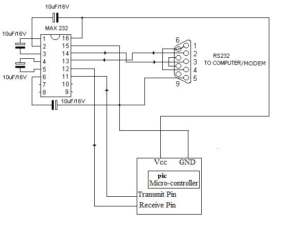

i m using a maestro modem which supports both text and PDU mode. and i m interfacing it with PIC 917.
i m able to send AT-commands using hyperterminal with the modem but when i communicate with the microcontroller, i m not able to get the response of AT-commands.
i m sending a string like this:
putc("AT \r\n");
but it is not giving the required response.....it is not giving OK...
my hardware connections are ----
for DB-9 connector-
pins 1,4,6 are connected.
pins 7 and 8 are connected.
5 is ground.
pin 2 is connected to TX of MAX and pin 3 is connected to RX.
Plz check the connections and guide me accordingly....

1. Make your interface connector signals on the board identical to PC's connector and then try.
2. On PC, pin 3 is TX and pin2 is RX, so please match it first.
3. Do you have the pinout details of the modem connector?

i already did that...and i have the pinout of the modem connector..i have done my hardware connection according to that only....
gsm module pic microcontroller
this is the schematic of my hardware. Plz check it.
my modem supports 9600 bps. AT this baud rate it is responding with PC.

I suggest you to remove the present connections to pins 4 and 7 of the 9 pin connector. Then:
1. You short pins 4 and 7 of the connector and connect to pin 7 of Max 232 IC .
2. Connect pin 10 of Max 232 to ground.
3. You also connect pin 8 of Max 232 to Vcc through 1K resistor.
Points 1 and 2 ensures that DTR and RTS will be enabled high (10V) if your modem looks for that for communication. This will ensure that the status of PC's connector pins match with your controller connector. Point No.3 is just to ensure that the rx gate is not left open.
In one of the recent discussions in the Forum, it was pointed out that MAX 232 should use all 1uF capacitors only in the place of 10uF caps used to be seen with some of the earlier designs. I am not sure how far the value of these caps will affect, however, it is true that all recent data sheets of Maxim/TI etc. show only 1uF capacitors.
Also, with these changes, you can connect your microcontroller card using a cross connected cable to PC and check if it works with hyper terminal under identical condition of Baud rate etc., which you used while connecting PC to the modem. It will ensure that your micro is working as expected.
Please give us your test results.
Regards,
Laktronics

Thanks for your reply...
But i can't understand ..what is the significance of these connections?
Can you please elaborate it more.
gsm modem interface with 8051
Yes, these connections will make DTR and RTS pins of your card interface connector high. In the cable connecting to your modem, these will be connected respectively to DSR and CTS pins of the modem connector normally. So, in normal RS232 communications if flow control is used in the modem software, it will not send any data to your card unless it sees its DSR and CTS as high, that is why these are required. Since the modem cable worked with PC, I find that your connections are only short of these signals and hence the suggestion. And ofcourse those comments about the capacitor value of MAX 232 also may be noted.

hi,
once check out your schematic. For MAX232 pin13 and pin8 are RS232 inputs.pin3 must be connected to either of it.
interface gsm modem pic microcontroller
Please do not confuse. Pin 3 of the connector is TX output and the connection is correct. Pins 8 and 13 of MAX 232 are Rx inputs, and one of them is connected to pin 2 (RX) of the nine pin connector and it is right.
