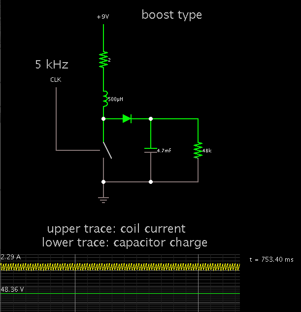

I am looking for some help in determining inductor (physically small as possible) and frequency etc. to charge about a 4700uF cap in about 0.8seconds (800mS) to a level of 48Volts with a 9V power source. - thanks in advance cb
i.e. Step up converter from 9V to 48V capable of charging 4700uF in 0.8 seconds.

You have to store about 5.4J. Depending on the tolerance of the capacitor, it may be more (say 8J). You want to transfer the energy in 0.8s, so that means the charging power should be in the range of 6.7 to 10W.
I would go for some boost converter topology (maybe with an autotransformer to get reasonable duty cycle) that controls on input current (in your case about 1A). Controlling based on input current (that is the current taken from the 9V supply) gives the lowest peak power. Termination you can do based on voltage with some hysteresis so when the capacitor voltage drops too much, it will be charged again.
To demonstrate how a boost converter might perform to your specs, here's a screenshot of my simulation.
The capacitor has reached 48V after .8 seconds.
Not shown is the beginning of the cycle. Initial current was over 4 A. (A boost converter allows current through the coil and capacitor no matter whether the switching device is on or off.) The capacitor quickly acquired a charge of several volts.
After a while current dropped to 2.2A. If your 9V supply can provide this then such a circuit could work.
A proper control circuit needs to be added to limit peak current. This would automatically alter frequency and/or duty cycle.

Thanks very much BtR - this is great and very helpful. For interest what simulation package are you using ?
It's the animated simulator at Paul Falstad's website:
www.falstad.com/circuit
You can interact with it by changing values, speed, etc. You can construct circuits of your own, as well as run the ones provided.
Right-click on a component, to bring up an edit window. Press Ctrl and drag to place components.
The link below will open the falstad.com site, load my schematic and run it on your computer.
