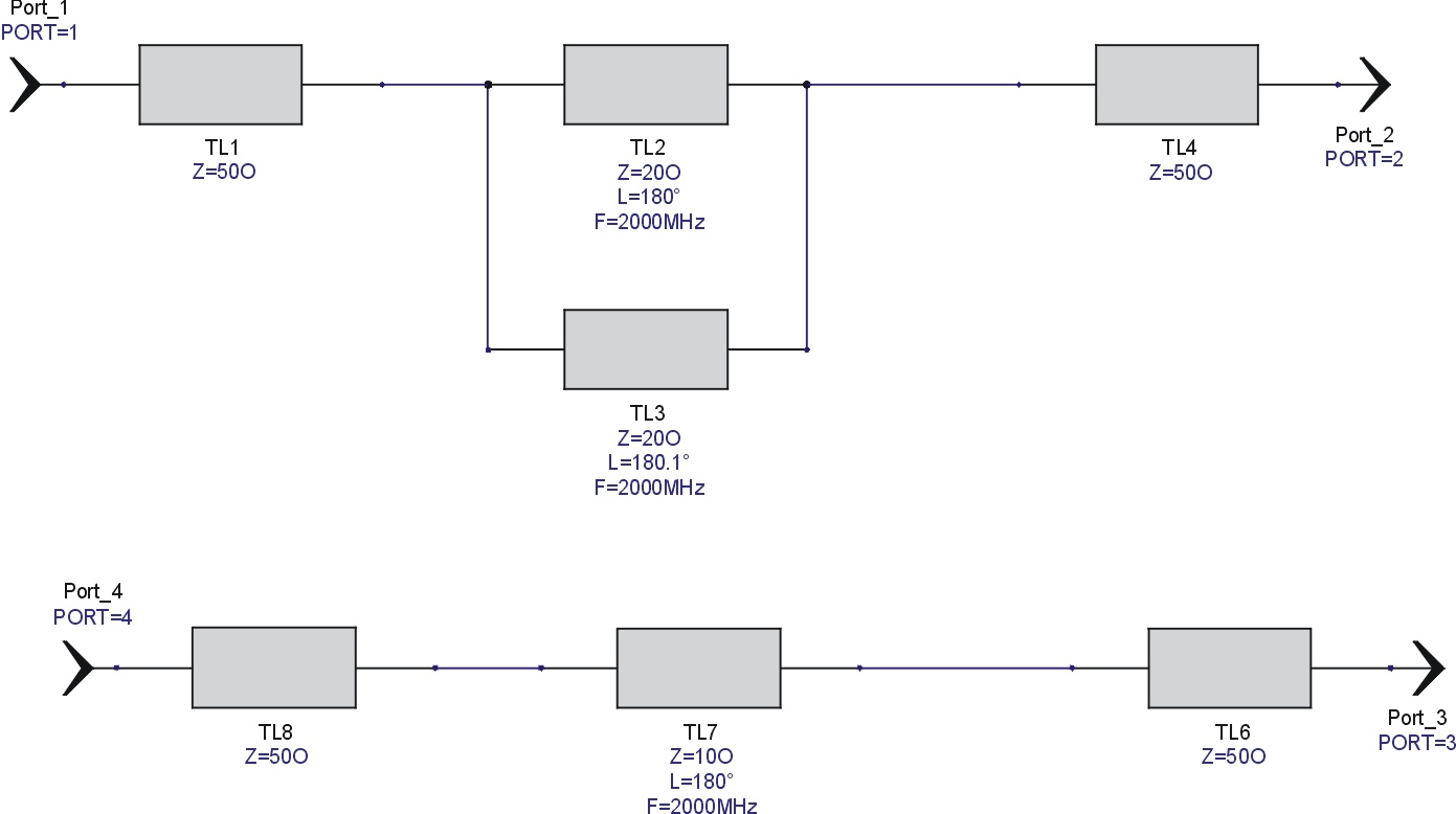

If that were true, then these two circuits should have identical responses, but they do not.
S11 is brown, S33 is blue

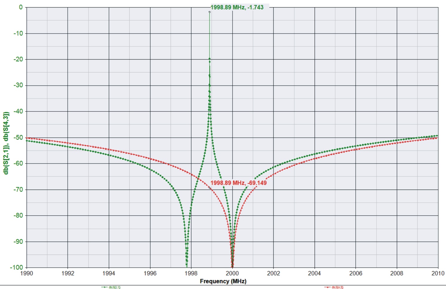

its even more pronounced in a bandstop type filter, where you can have a tiny passband midband!
S[2,1] is green,
S[4,3] is red.
sorry, just realized you can not read the schematic...damned computers! the two stubs are 90 degrees at 2 GHz and 90.1 degrees at 2 GHz, both 20 ohm characteristic impedance, in the top circuit
the bottom circuit is just a single stub, 90 degrees at 2 GHz, 10 ohm characteristic impedance.
Obviously, the two circuits have VERY different responses.

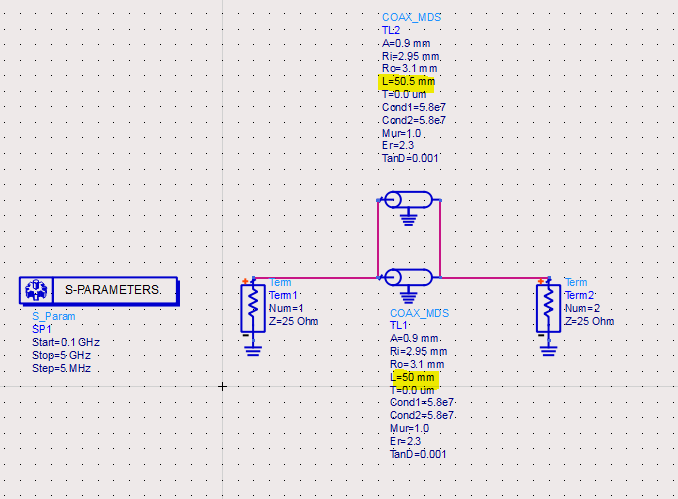

The "antiresonance" peaks are obviously there. Your simulation shows that rather small length differences matter if paralled transmission lines would be used in a TL resonator. Similarly, if you are making a matched transmission line system e.g. 25 ohm source, two parallel 50 ohm lines, 25 ohm load, small length differences are causing s21 notches. They definitely matter if a small band signals hits the resonances.
My "indentical behaviour" claim is only valid for the ideal equal length case.

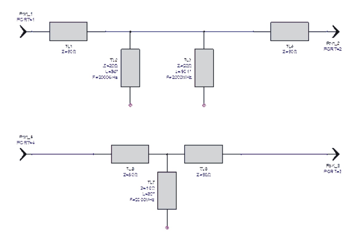

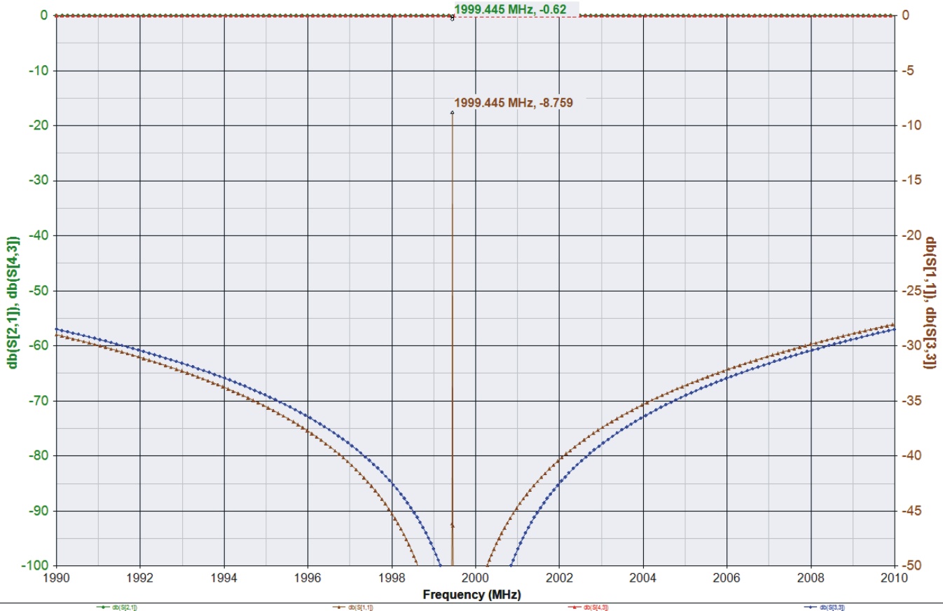

This is a different case, because you have connected the two lines only on one end. If you connect both lines at both ends, you will notice that the spike disappears.
No. You get different behaviour but still resonances as soon as both transmission lines have a small length difference. You can check with the simple setup proposed in my previous post.

maybe there is a language problem, are you saying to take the two open circuited stubs, which are physically different end point locations, and try to connect them together? how would you do that in microstrip? typically you would lay the two stubs out on opposite sides of the main line so you would not have a parasitic coupled line.

Sure. What I did was just an ideal nodal connection at schematic level. Not realistic, but closer to the topic discussed here: parallel lines that are connected on both ends.

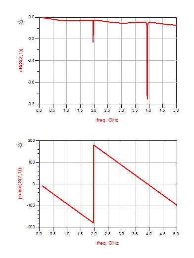

But anyway, after creating a setup like FvM suggested, I can see the issue. I was wondering how real this effect is if we include realistic line losses, but it's there. There is an issue when the line length is around lambda/2 or multiples of that.
so, you are saying if you have identical line lengths, like to the same micron in length, and no other non symmetrical parasitics, you can do this! sounds like a very useful design tool to me!
It's quite common, but you have pointed out the limitation: lambda/2 length must be avoided. Thanks for that insight!
