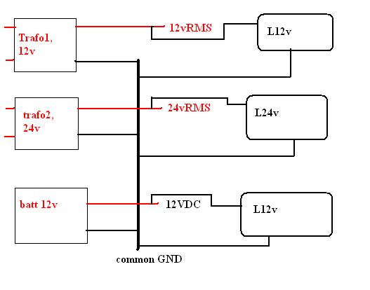

guys,
is it possible to use a common gnd for different transformer and battery? positives are different ofcourse... but grounds are tied togather... will it work??
because i'm in this situation... a uC, powered from a trafo will send a high state (5v) to light an led. also it will send this state to a different uC and board... that board and uC is powered from a different source... so if i tie all the GND togather, always current should get a path to come out... and should found a voltage... (if i'm not wrong...)
advice plz...
