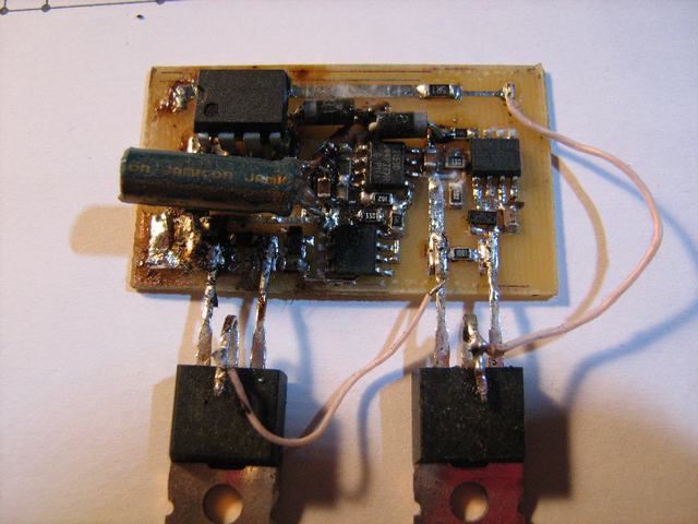

Hi DeepOne
greetings thanks for post 48# added one more pair and increased load smps is working will post pics to show you my work
warm regards
andrew lebone
Hi Deepone
greetings and many many thanks for your help and guidance in making me complete this smps only regrets no protection
but its a great smps in 2 pairs IRF460 on resistve load halogen ac current drawn 9 amperes cant ask for more picture with my
dclass amps sound was very clear very satisfied with smps anything bigger you have for me to make viper ic is working i used VIPER22A
warm regards
andrew lebon

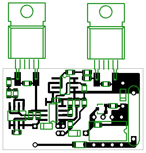

Hi Deepone
greetings i am going to try your message from #44 please can you give details of current sensing transformer core ans swg wire details
i have yellow core from pc supply OD22MM ID 14 MM H 7MM is it ok to use
warm regards
andrew lebon
thanks andrew
can you share pcb in pdf format, i have no pcb for this project

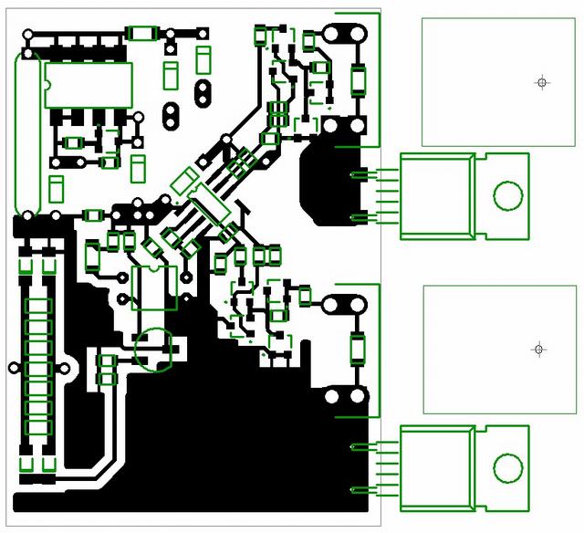

Hi Deepone
greetings tried both ocp circuits when i use TL431 and opto 817 smps does not come on when i use 555 ocp smps comes on but ocp not working
please any tips
warm regards
andrew lebon

greetings Andrew Lebon
Well, probably this signifies that optotransistor is open or perforated. To understand why it is possible to walk on scheme with voltmeter. Of course it is necessary disconnect power part from +310VDC for time of the testing. Apropos better use thyristor (like bt136) instead of TL431. Since if thyristor is opened that is latched.
about this me not known nothing ).
