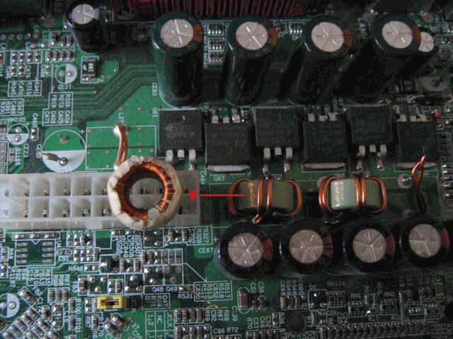

yes, without problems. apropos good inductor possible to make with ring from old motherboard.

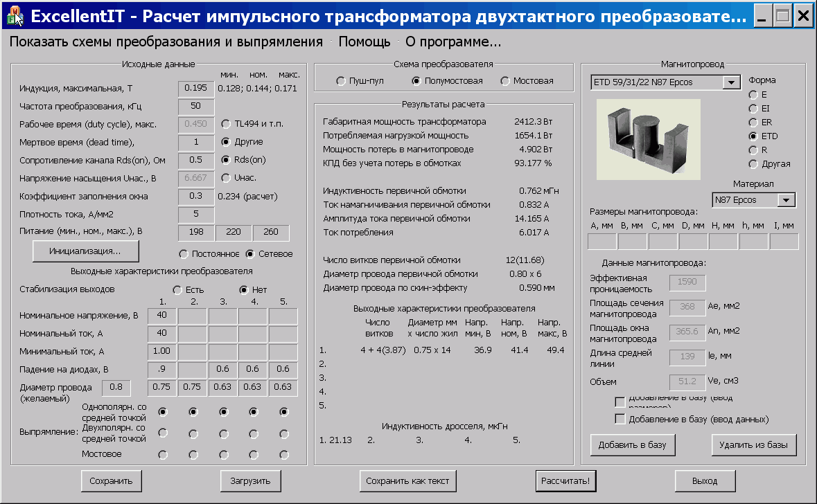

In past i have done welding device on this power so approximately think yes. But better if you have oscilloscope, if its no, better spend pair of evening and make it from atmega32 + ad9280 + display from Siemens 65 cellphone.

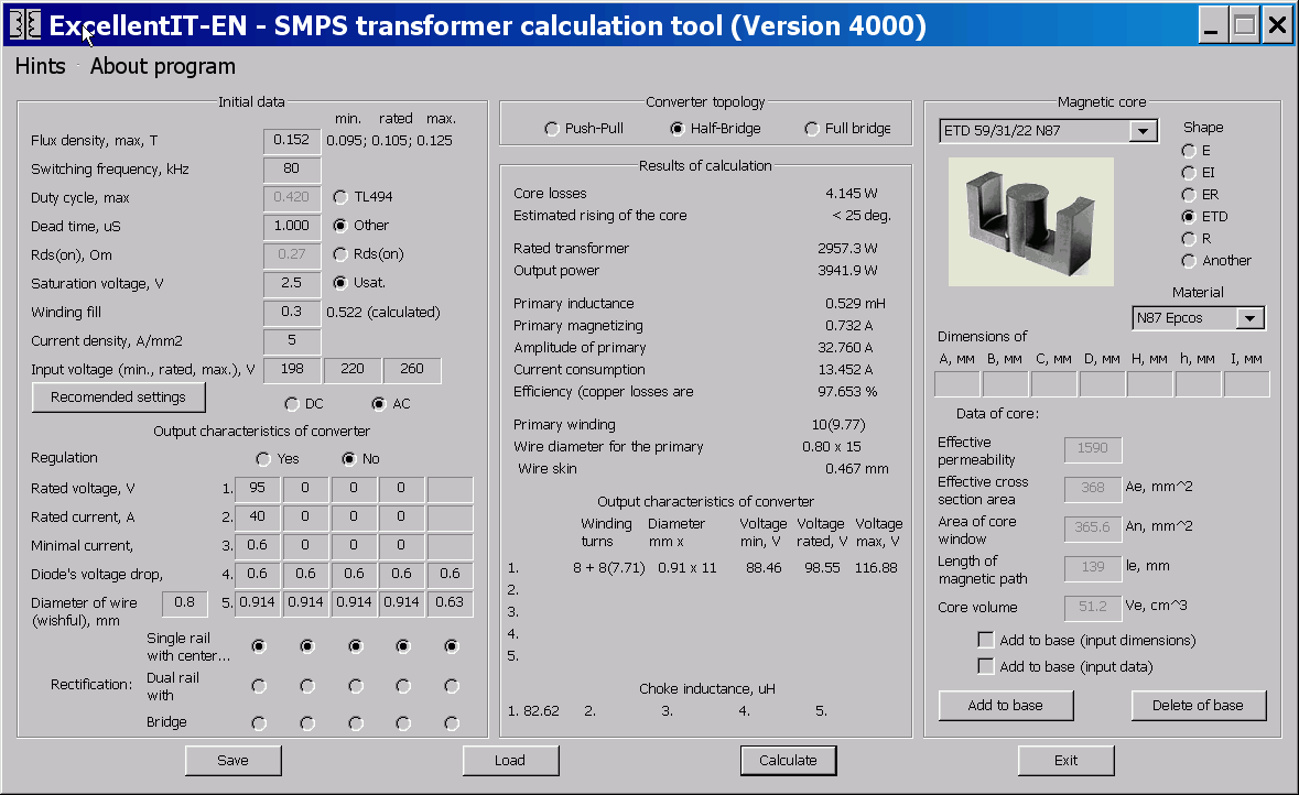

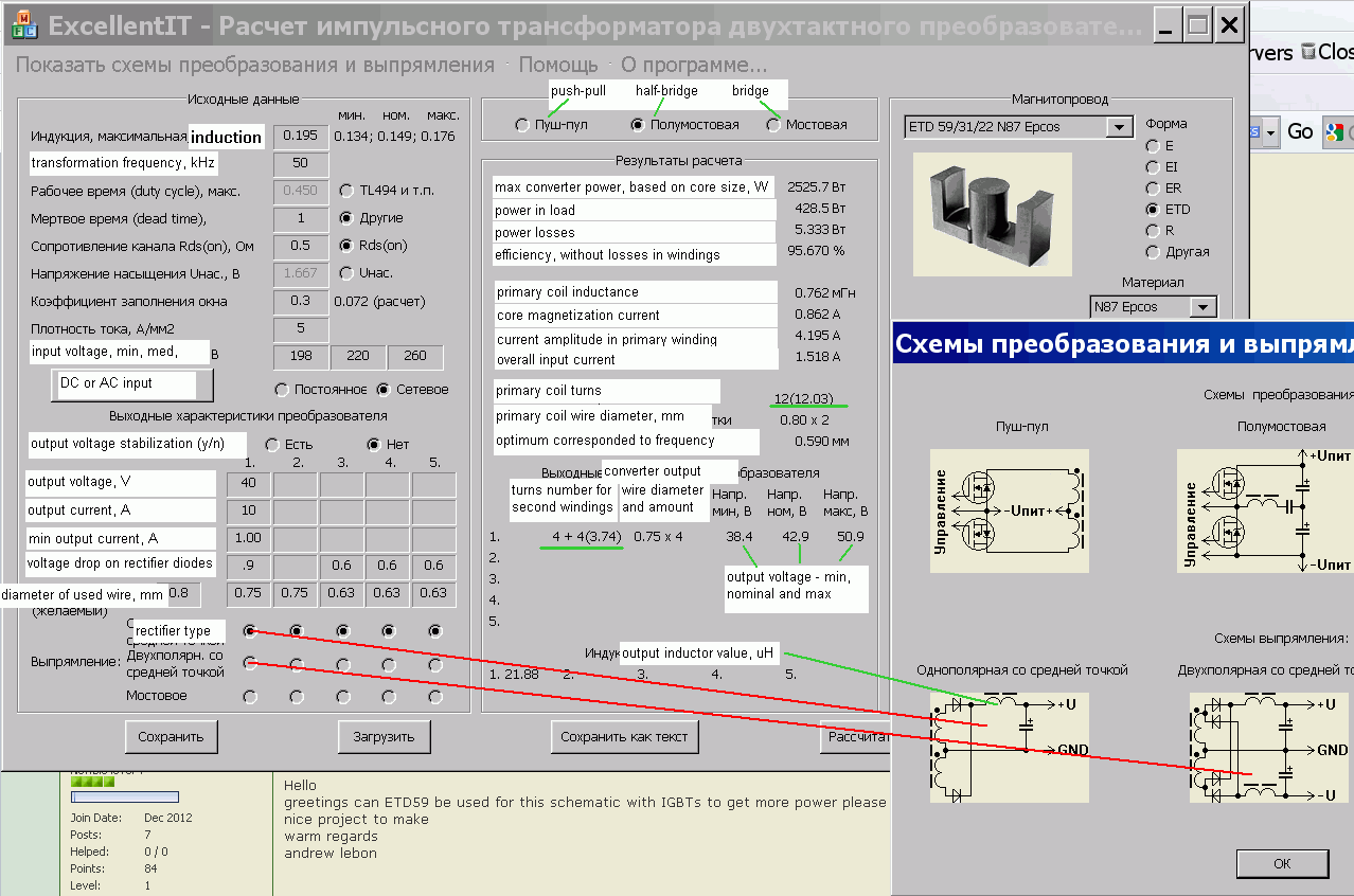

ok ill try my best to make layout base on your schematic ill post it soon,,what would you suggest to use ETD49 or 59?
Transformers with bigger sized cores is easier in fabrication. Also with ETD49 density of current in coils wires will above and will be necessary efficient forced cooling.
On the other hand with ETD59 slightly bigger magnetization current.
All this may easy evaluate by means of Andrew Lebon attached program (in message #24).

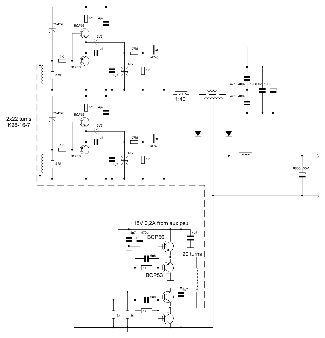

Ok thanx for the info in my case its hard to find this 1.5ke440CA locally ,,is it possible to use irp460 2 pairs with totem pole on this design with EE55 or ETD 59? how much power do i get ,,,and i would like to ask how to make gate driver transformer using ee19 or ee 16 can you give me information of the primary and secondary turns and wire gauge to be used? pls
Think yes, but i did not try this.
You may define this with program attached in message #24.
With GDT this will look approximately since on this scheme

Can you pls post full schematic on this design
Why not ) This is aging scheme, already presented in other topic.
