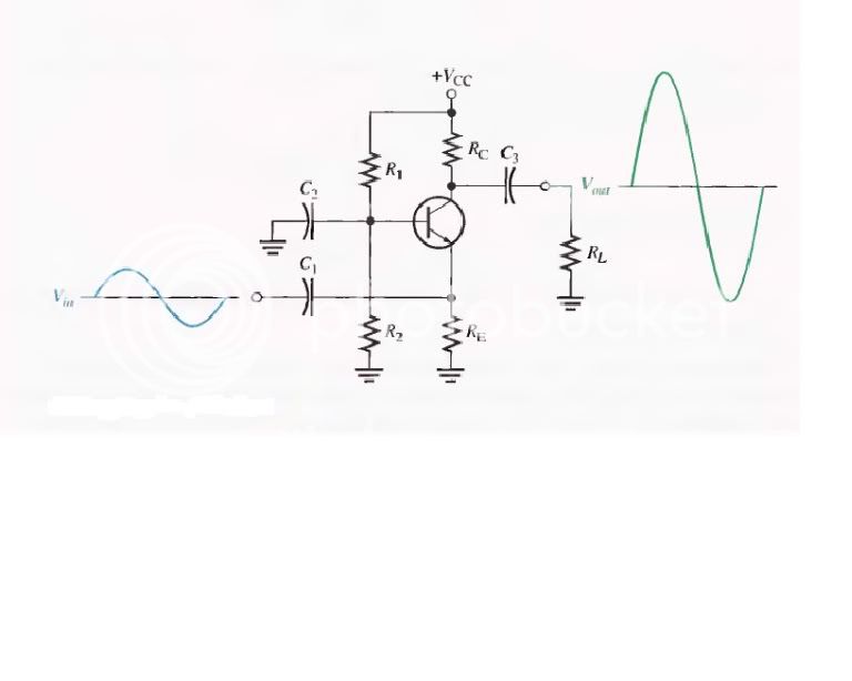

Hahahahahahaha...... You are funny too.. OMG.. You very good person. :D
goldsmith said:
Of course i'm not referring to that circuit . CB complementary means with two transistor !
So you mean complementary i.e. one NPN transistor and other is PNP. Right?
Here is what are you asking for.
Attachment.
But how to modify it as CB configuration?
Conditions for CB configuration:
1) input at emitter.
2) output at collector.
So how to do it?
Help please

Hi shayaan
That is in CB arrangement . what do you think about it ? have you access to any simulator program ? if yes , you can convert it to a CB amp and then test it ! and attach the result ! try to earn success .
Yes I have access to a simulator program. But how to convert it into a CB configuration?
I know about CB that input is at emitter and output is at collector while base is grounded.
But how to do it?
An example that you'll be able to get the idea with that :
Consider that we have a transistor , and the emitter is grounded via a resistor . and the load is in collector ( between collector and supply ) . and the input is connected to the base ( via a resistor ) what you'll have ? a half wave CE amplifier . with some changes you can convert it to a full wave CE amplifier ( 2 transistors ) .
So , i think you can predict the way to achieve a CB with this example ! can't you ?
Yes of course I can. But this is not a problem. Problem is how to take output?
For output collector of two transistor should be attached together like in emitter for input. Isn't it?
