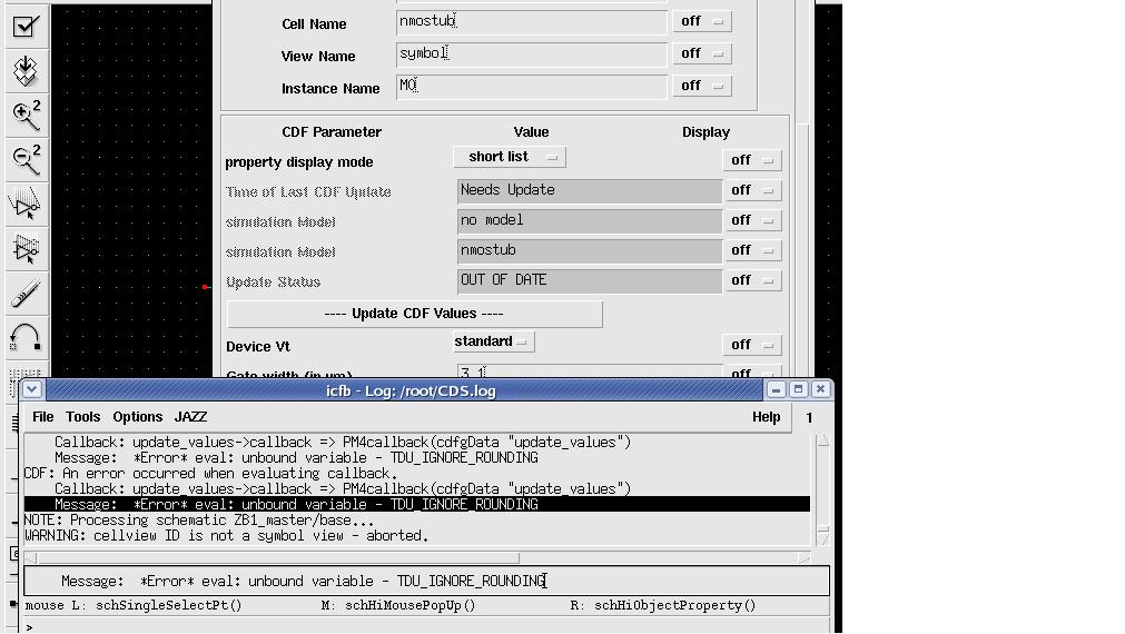

When i use the pdk simulating the circuit ,I found the cdf parameter can not change ,and it shows "needs update" ??
Why ??
In the CIW it shows unbound variable!!
Any one can help me ?
Very thanks!!!!
you should click "Update CDF values" after you chang the parameter value
yes ! I choose it ,but it can not be update!,And in the ciw it shows some variable should be set!
you software's version ?
or,you can install the pdk again. maybe some error while installing the pdk.
and you can use the online help, the engineer of jazz will help you.
