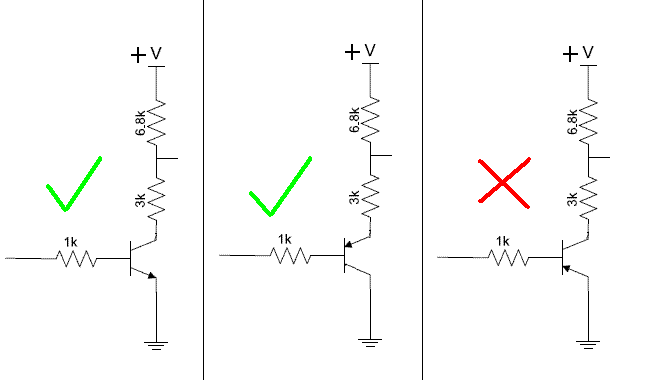

Then either the BC807 is upside down or it should be replaced with an NPN transistor.
Yes, that's the problem. The emitter is grounded and the collector is connected to a positive voltage. The emitter of a PNP transistor should have be at a more positive voltage than the collector.
i m tried that logic also. even 1.2 volt drop occur. there s nothing in that transistor switching.the problem is voltage drop occurs in second p channel output
