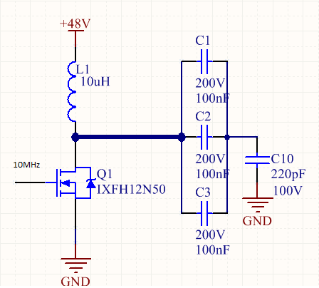

What capacitor to use?
Need a capacitor for high current and high frequency.
In other words,crucial is
- ESR and dV/dt
used, for example, **broken link removed**
I wonder compared to ceramic or other small SMD capacitors
May be, on the other hand, when a large increase in the steepness of the voltage (dV / dt) ceramic capacitor may be damaged more easily than PP
