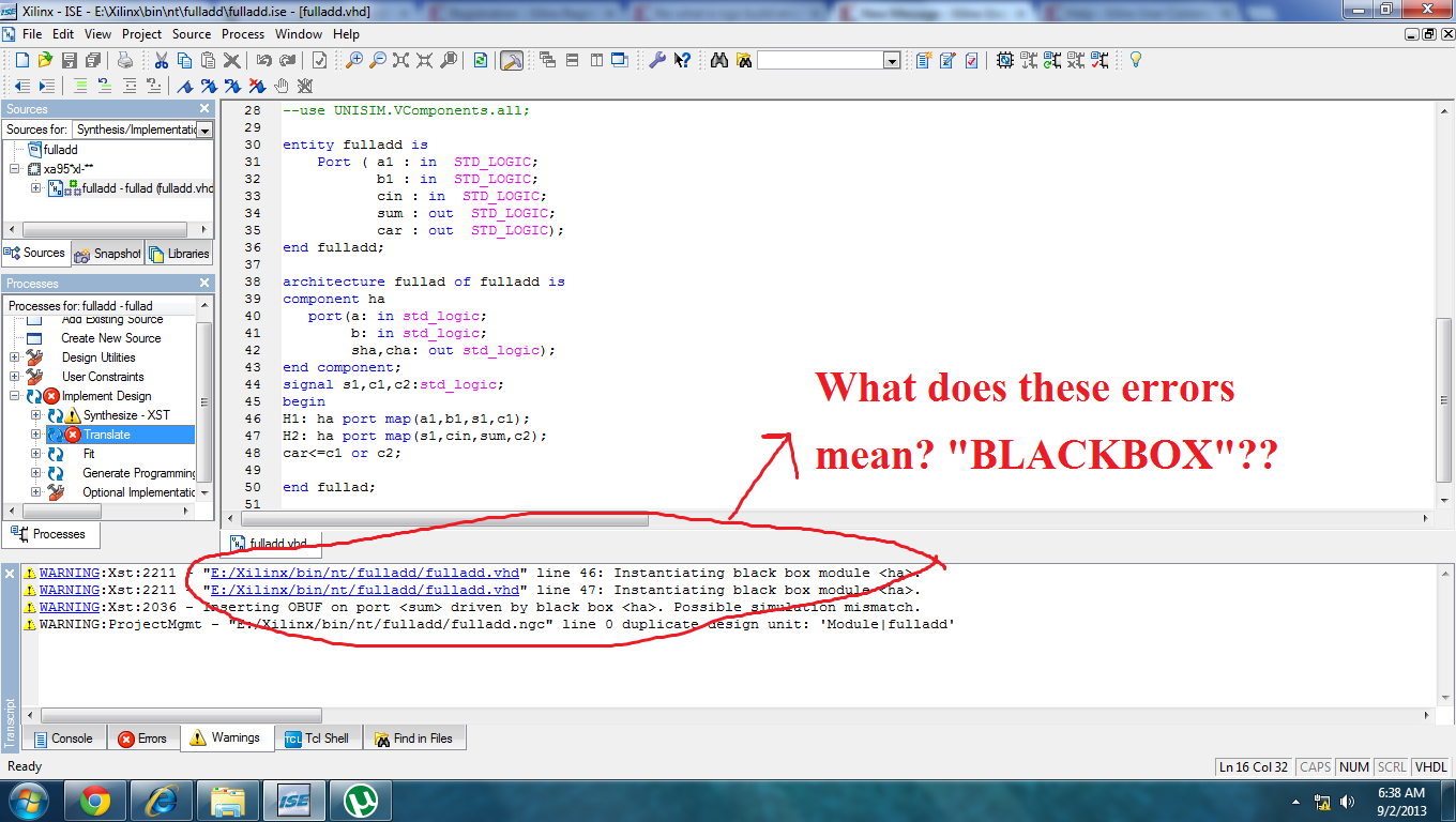

hi !! i was designing a full adder using two half adder using the following program, but constantly i got the same error. please help me. any suggestion is acceptable.

the ERROR i m getting is:
ERROR:NgdBuild:604 - logical block 'H1' with type 'ha' could not be resolved. A
pin name misspelling can cause this, a missing edif or ngc file, or the
misspelling of a type name. Symbol 'ha' is not supported in target
'xa9500xl'.
ERROR:NgdBuild:604 - logical block 'H2' with type 'ha' could not be resolved. A
'xa9500xl'.
https://obrazki.elektroda.pl/4190037900_1378089675.png
https://obrazki.elektroda.pl/9776619300_1378089676.png
