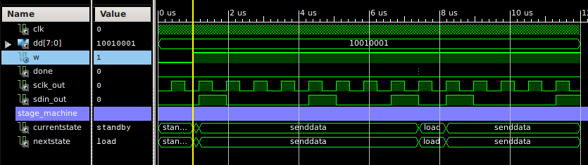

Ok let start with the requirements we want to have a SPI interface to a separate device. For now let just say one way communication, and let forget for the time being to the control signals. so we are left with data buss which is serial as you may have guess it and clock signal and let package is 8 bits.
So we have faster clock which we can call it main_clock,
we have 38 division of that clock and we called clock/38 it has to be 19 clock circle down and 19 clock circle up. and need to be send to device two.
now we are left with block of data arriving parallel we want to send it serial.
also we can send data constantly without stopping 8 bits per package.
I my opining all that before was not relevant but as you asked here it is. Why?
Because I dont want you to give the code and dont want you to fix my code either. I am interested on learning how to code from understanding at least in this task. I have one SPI complete and example of serial interface.
I did what you have suggest and test it and it works but I some extend I was testing it at writing on
If I write on 1 us you can notice on sdin_out bit dd(0) is not right. but there is nothing wrong we have design it as you suggest but you still have the issue that the register is moving at another clock domain (by the tick enable). to illustrate I am attaching the simulation graphs.
Images:
http://obrazki.elektroda.pl/4318650400_1372972026.png
http://obrazki.elektroda.pl/3452409600_1372972026.png
http://obrazki.elektroda.pl/7974188300_1372972026.png
one here you have the effect of load if it does not wait for a tick of clock/38 (4318650400_1372972026.png)
on here I was writing a 385 ns (this is the first clock38 goes up ) that is not problem because that is in sync with clock38 tick. (https://obrazki.elektroda.pl/3452409600_1372972026.png)
and in here I have make load to wait for a tick signal from clock/38 to move to send_data (https://obrazki.elektroda.pl/7974188300_1372972026.png)
You can know notice that load is now one clock circle (clock/38). Clarifying this is now one issue from two clock domain but about the shift register two clock domain I have changed as suggested earlier. For those which need more data = main clock create a clock/38 and with clock/38 create clock38_tick signal which I have used to tick the register on the shift_register by enable evaluating a main clock.
Is this not enough?

Aaaaaah, so that is where your crop circles are coming from. Where you say "clock circle" the rest of us says "clock cycle". :p Best use clock cycles in future posts because then we understand wtf you are on about.
There is still only one clock domain. Just because you're generating the SPI clock and it happens to be 1/38 the frequency of main_clock does not make it a 'clock domain'. At this point, it is simply a signal and it is not used to clock anything.

OK, but now you have to put some thought into the interface into your block. Since main_clock runs much faster than the SPI interface the thing that is external to your block which is providing the data to be written will need some form of 'wait' signal. I would suggest the following interface by your block of code to the external thing that is the source of the data that you are trying to send out the SPI interface

Because you were unable to describe what problem you're having. To this point, you still haven't but at least this posting of yours is a bit more promising
OK...the SPI master (i.e. the one that generates the SPI clock) or the SPI slave (i.e. the one that receives the SPI clock)?
You did attach them...you didn't describe what the problem is but I'm guessing the problem is that your state machine went into the 'load' state for one clock cycle while keeping the SPI clock running thereby messing up the receiver since valid data was not received.

Not really since you haven't stated the problem, I had to deduce it from the waveforms. You also haven't indicated where the other clock domain is, but again I'm deducing that you are thinking that sclk_out should be a clock domain (if you are using it to clock something then you need to stop)
Since you want to fix the code yourself (which is good), then we can only give generic suggestions but those should be good enough to get you on your way:
- If you are using anything other than 'main_clock' in your block of code then you will need to rewrite it to eliminate all other clocks.
- Consider a state machine that works something like this:
- Idle state transfers to senddata state when write input is active
- When in idle and write is received, initialize a counter that will count from 37 down to 0 (will be used to generate Sclk). Initialize another counter that counts from 7 down to 0 (will be used to keep track of which data bit you're sending)
- While in senddata state decrement the 37..0 counter by 1 until 0 then reset to 37 unless the 7..0 counter indicates that you've sent the last bit. At that condition, transfer back to idle state
- wait output is active whenever you're not in the idle state
- Sclk can be reset to 0 while in idle and then set it to 1 when you're making the transition out of idle; set it back to 0 halfway through the 37..0 counting
Notice that there is only one clock domain. The above description can be made to work so that there are no gaps if there is new data to send and it will come to a clean stop if there is nothing new to send.

I have attached the Simulation, you can see some problems right the way. clock/38 is off sinc and loading into register is wrong too.
The other interface evaluate on the positive edge of the clock_38
Sounds like you are still using two clock domains - needlessly. Timing problems can be expected.
Doesn't clarify much. We need the code and testbench to understand the details.
The clock_38 can be easily fix by making resent to "100110" and not to "000000"
here is simulation:
Now if you notice data out is wrong because shift register is ticking over by clock_38_tick1'event and clock_38_out_tick1='1'
as you can see from the simulation here:
Also I try to changed leading when reset not to "0" but as you see it not working.
I can see the problem which its in bit_transmitting "0" we want one clock_38 event, but we dont want the shift register to shift.
I suggest, add loading process to stage machine?

It's OK to generate an external SPI clock in the code, but according to the rather slow SPI clock, everything can still work on the main clock's edge. Usually, as long as the SPI clock can be generated by dividing the main clock, you don't need to start a second clock domain.
Sorry about the thought of negative edge, that was wrong? the register would move in half cycle.

If you notice I am using a tick signal from that counter! What do you suggest?
Also from the datasheet I am attaching a transition requirements:
Would you still send a tick signal?
What is clock_38 in entity spi_forum?
*grin* I love the way you incorporated all the suggestions in this thread so far. Especially the bit where you persist in using a counter to generate your divide-by-38 clock. Well on your way to a good coding habit! XD
I don't agree.
Although you might not recognize it at first sight, Peter is now applying the previous suggestions to implement the SPI interface in a single clock domain. There are probably detail faults, but the basic topology is a reasonable synchronous design.
On the other hand, the bare SPI function can be probably implemented on 1/3 or 1/4 the number of code lines. There's also some garbage like an unsused shift left function. It will be ignored in synthesis and most likely doesn't cost resources but affects code readablity. There are also some inconsistencies, you have a word length parameter, but the internal bit count is fixed to eight.
Personally, I tend to put a trivial SPI interface like this in a single process.
