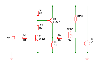

This is the MOSFET Driver circuit i have designed. Please comment is is true ? Thanks. My PIR output is 3.3volt. When i connect directly with IRF540N it works but my Display (load) is little dim. Means directly using 3.3v its not fully on.
sorry the transistor symbols are wrong...else i think everything is fine... please do comment...will it work.. i want to use IRF540 as Pure switch as its RDson is very low..
Please post you circuit with the proper transistors symbols since your posted circuit will not work.
What is the output voltage from the PIR sensor?
The IRF540 requires a gate-source (Vgs) voltage of +10V to fully turn ON.
Here's an untangled drawing. I changed R1 and R2 to (IMHO) more sensible values, and added another three resistors which weren't in the original schematic but seemed like a good idea to me. I'm not sure if the gate stopper (R5) is really needed though.

Where is way for collector current BC557?

Why so complex?
Consider that the voltage drop across the IRF540 about 0.5 V at 12 A
Why so complex?
Depends what polarity he wants. Your circuit switches on the MOSFET when the input is low. Mine switches it on when the input is high.
The optocoupler nikhilt007 mentioned is a nice simple solution too.

I donno why it is working but output from PIR is 3.3Volt and IRF540N is switched on easily. If i give 3.3Volt and is turned on, means there would be less voltage/current flowing ? full current will flow only when its 10Volt ?
