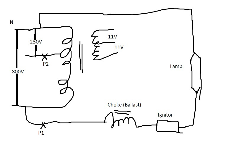

Hi all,
I got a little problem recently. :-(
An HID MH lamp in a UV curing machine (a.k.a platemaker or printing down frame) used in printing industry, is using a Transformer to step up 230V to 800V to supply the necessary voltage for the lamp. the transformer primary is working as an Autotransformer and providing this voltage. and the secondary is just a 11V-0-11V design. I attached the rough sketch of the wiring diagram.
The problem is when the machine is powered up, and after the lamp has ignited, the transformer's 230V winding is drawing ~65A (measured by my clamp Ammeter at point P2) current which is totally unacceptable (the machine is rated to 30A with including lamp, several motors, and all other stuff, but this time, I turned off all other stuff except the lamp) and the main service breaker is tripped due to exceed of the maximum current. but in the lamp circuit it only draws the ~19A (Measured at point P1) which (I think) is the normal current for the lamp. And when I disconnect the lamp and turn the machine on, the transformer primary alone is drawing ~15A and I think its unacceptable too. and the (such a big) transformer is getting hot quickly in the time period which the lamp has turned on and the main service breaker is tripped. which is less than 2 seconds.
It is a big transformer with about 20Kg of weight.
Can anyone help me to solve this problem?
There are two points:
- the measured lamp current of 19A matches almost perfectly the input current 65 A according to 19 * 800 = 66 * 230
- the other question is, if the lamp power is actually as high as 15 kW? And is the transformer rated for this power? This could be only answered by referring to the lamp and transformer specification.
In my ears, both the 800 V operation voltage and the 15 kW power are sounding rather high, but not impossible, depending on the lamp size.
In addition, a 15 A no load current won't be a problem, if 65 A is actually the rated current, referring to a cos phi as high as 0.97.
20Kg doesn't sound heavy enough to be a 15KW transformer, even if it's just an autotransformer... I'd make sure it's rated for the primary current.

Well according to your own measurements, you were delivering 15.2KW to the lamp. So either your measurements are wrong or the specs on the lamp are not what you think. Or it's defective somehow.

So the transformer is included in that 30A number? If so then there's definitely something up on the load side.
Good point. A 230 to 800 V autotransformer only has 40% higher rated power than an isolation transformer of same size. So the the said 20 kg aren't good for more than 3 or 4 kW rated power, possibly somewhat more, if it's designed for low duty cycle.

I suspected that too. but the lamp's light seems normal and with my experience, I cannot see any anomalies in the lamp. But now I can understand the 19A is pretty much higher for the lamp. So maybe the ballast is defective.,
But how do I check the ballast without knowing the specs or lamp wattage correctly (the lamp manufacturer didn't print a single letter on the lamp :-( ?? ). coz all the documentation are unavailable for the machine and I had to totally depend on the multimeter readings. :-(

You should be able to get the required information, either from Printer Supplies (PVT) Ltd. Sri Lanka or Theimer Germany. A defective ballast could explain a too high lamp current, but the reported no load current of the transformer suggests a different problem, e.g. a wrong machine wiring. I'm somewhat surprized to hear about 230 V transformer primary voltage, because the standard machine supply seems to be three phase 400 V. At power levels above 2 or 3 kW, one would preferably use a phase-phase 400V input voltage to the transformer. It's only a guess. But if I'm right, the correct transformer circuit could be something like 400V : 560 V. An interesting point would be to determine the lamp voltage in operation.

In this case, I would believe the machine type plate. Operating a 60 Hz ballast at 50 hz involves an unwanted 20% current increase, but much less than the factor you're looking for.
