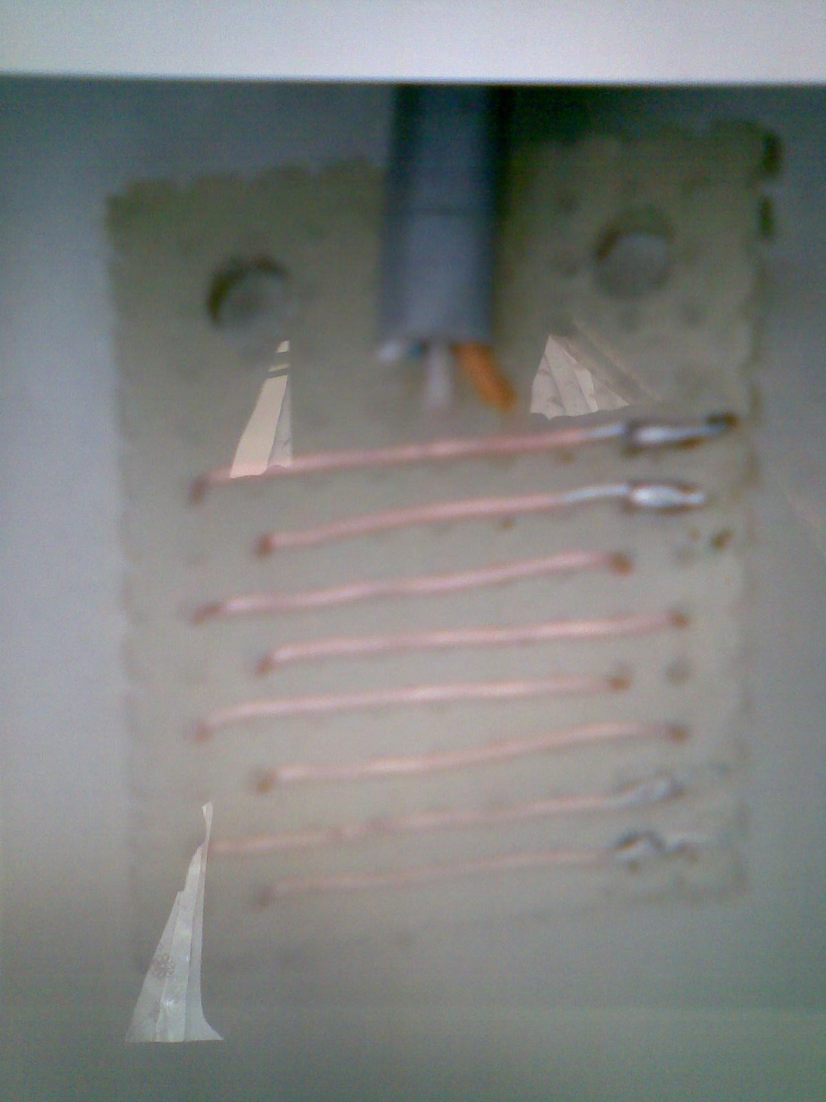

i need some help regarding my final year project..
i currently doing about alarms system...i want to activate this alarm system during daylight..
n turn it off at night..
sir,,i want to ask u..what kind of pic that i have to use.?
n how about the source code..?
rain sensor circuit final project
Because you don't mention too many details, a simple suggestion is to get PIC controller with Compare module integrated, then connect a light sensor to it, set it out to be activated during the night (when the light sensor does not detect daylight) and de-activated in the morning.

ok sir,,my system is about alarms system,,
i working out a project about rain alarm in my sport complex,,
basically the project flow is like this...
when raining..the circuit detect the rain,,and triggered the alarm,,
here come the problem...
1)this rain alarms only working on daylight..when at night..it is shut off..
so i need to build system or operating hour for the system,,start from 6am to 6pm only..if the rain fall without the range of operating hour..nothing happen to alarm,,
2)i dont know to choose and use what kind of pic..please make a suggestion sir..

erm,,as far as i know..after doing some research on the internet..
i dont find any specific rain sensor..
it is all homemade rain sensor..with just 2 wires build with a gap..
i'll attach the file that contain the rain sensor that i will use...
if u have some info about the specific sensor,,just tell me sir..:D

you have earlier said that you have made a rain detector circuit which has a loophole that it works only in daylight but not in night. so you want some help so that it could work in night too. right???
so is it the same rain detector....home made...in the above picture shown...which you have already implemented but not working in night.
please specify it clearly so that we can provide you an exact solution. :) :)

For the time, you can use a RTC (Real Time Clock), and be checking the time on it, every minute for example and based on this time you will trigger the alarm on or off.
Look for Real Time Clock Chips on the internet

it is not like that sir..now i only have the rain detector circuit..
and currently..the circuit will trigger the alarm if rain fall...and will trigger in anytime..
in daylight and night....
so..i have to create a system so that the rain detector only trigger the alarm if rain fall in daylight...
so in order to do that..i have to use PIC right?
then what kind of PIC do i have to use?
any suggestion sir?

You can use a pic16f88 or 16f877A with Maxim1307 RTC chip , if you want to sense light you can use LDR, I have designed a time operated switch with pic16f877A and maxim 1307 chip programed in MikroC. I will convert it to web format and I will post it in my blog soon. watch https://picmicrochip.blogspot.com
