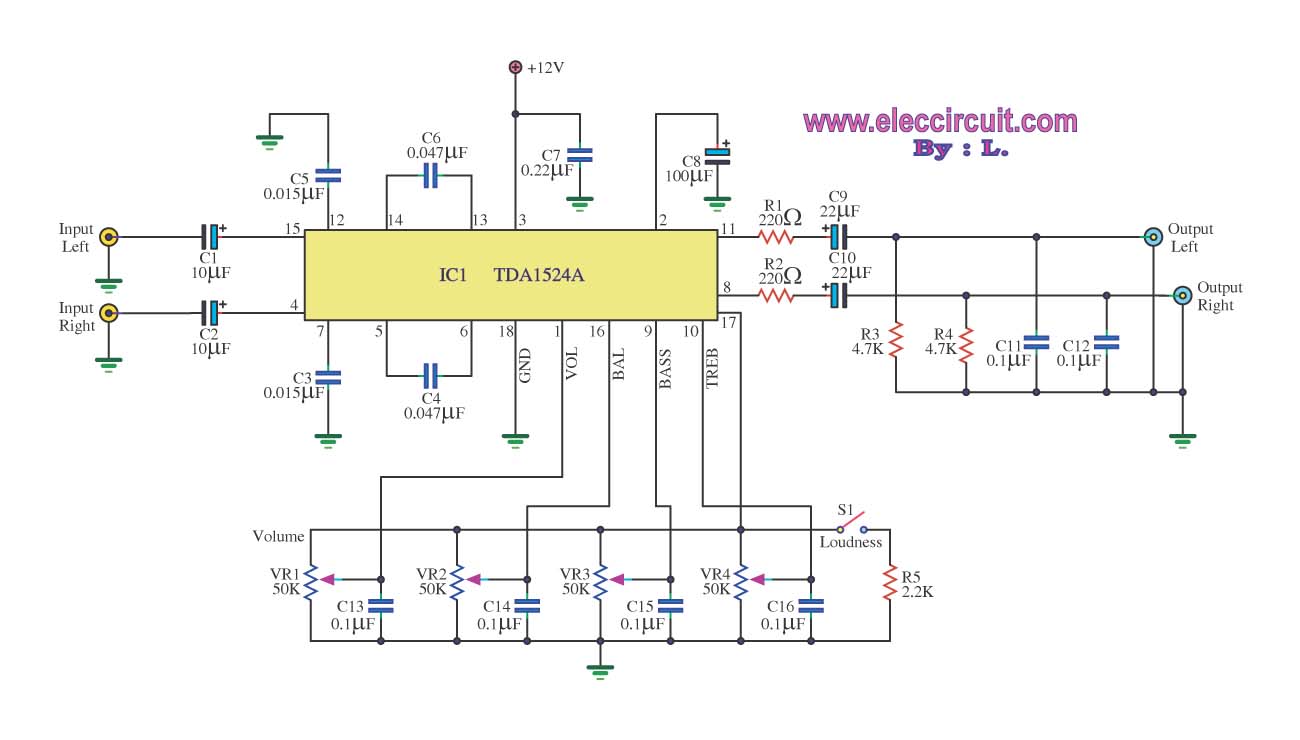

Thoughts on these audio amp circuits?

I always use laptops as the input source, with the gain it had originally its now really low when used in doors but when compared to other amplifiers its significantly lower has less mid range frequencies
Maybe you are using the headphones output of the laptop instead of the line outputs?
The mid frequencies from this amplifier are perfect. The other amplifiers probably boost the mid frequencies. The tone controls on my sound systems are always set to no boost and no cut because my speakers are good. If your speakers are mounted above the floor then you hear the original sound plus a reflection from the floor that has a longer path causing phase shift and cancellation of mid frequencies.

what is the purpose of the switch at pin 17?
When making this can I keep the circuit closed?
The TDA1524 tone controls IC is obsolete and not made anymore. The two largest electronic parts distributors in North America do not have any.
Ok what about the Lm1036 is that outdated also.
One opamp can make a good Baxandall bass and treble tone controls circuit instead of looking for an obsolete IC.
I mentioned 1 Ic and I was told its obsolete and I mentioned lm1036 so now I am asking if thats obsolete... the opamps that are avaliable to me I have tried them and they all sound trashy I just wanted to try something else.
If its case I can use an opamp to build a good preamp cant I get a proper schematic from one of you guys, I have asked before but didnt get anything so I have to try to find some and ask about them.
You do not show what part of the world you are in. I buy electronic parts from the two largest electronic parts distributors in North America. Digikey shows that they have no LM1036 ICs in stock but they can get some if you buy 236 of them. Newark has 248 of them in stock. Texas Instruments (they bought National Semiconductor who invented the LM series of ICs) say they have some in stock but they are not made anymore.
There are thousands of excellent audio opamps produced, they sound perfect.
I am in Jamaica. Your saying that but still not showing me any that's why I keep asking about random chips, both chips that are outdated still sell in my country yes I know it can be outdated and some people still have left overs, but that's why I said since there are so may could you provide a link to a schematic or something.
I had a nice honeymoon in Jamaica 38 years ago.
You can find circuits using the obsolete tone controls ICs on their datasheets.
Here is a link to a good Baxandall bass and treble tone controls circuit. **broken link removed**
Any dual audio opamp can be used like a TL072 or an OPA2134.

I occasional do readings on the different classes but since you told me to check them out and make a choice I was thinking for smaller setting low power I would use class AB amplifier like how I have been using the Tda7293 for the longest while but what I wanted to do for higher power was to use class D amplifiers I even selected a chip so far that seems to be popular with making class D amplifier and also inverters which I plan to make both so I plan to get used to that chip and it has a basic schematic in its datasheet that you guys could check out I will do more reading to see all that I can figure out.
Its the Irs2092
The datasheet for the IRS2092 Mosfet driver IC shows no spec's for a class-D audio amplifier. The spec's are on a datasheet for a reference circuit design called IRAaudamp5. It produces 100W into 4 ohms with low distortion or 120W with a little clipping distortion. Its frequency response cuts 20kHz a little with a 4 ohm load or boosts 20kHz a little then cuts higher frequencies with an 8 ohm load.
They do not say or show full power with an 8 ohm load but it is probably 50W to 60W with the plus and minus 35V power supply also used for the 4 ohm load.
I refer to it as class D because I see alot of circuits in forums that are said to be class D and thats the chip they used. But I would take a recommendation for a chip you have used a DIP.
