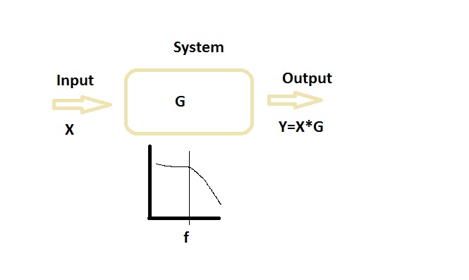

Hi i think if the input signal X is fed to a system with a transfer function G, the output Y is obtained by modifying X by the system in accordance with it transfer function G.Say now if we are increasing the input signal frequency of X , but since the system has a finite bandwidth the output modification(Y=G*X) will be correctly done only up to a certain frequency say f. So this 'f' is the system bandwidth.
For signal band width of X , it is determined by the highest frequency content present in it.
Im i correct??
